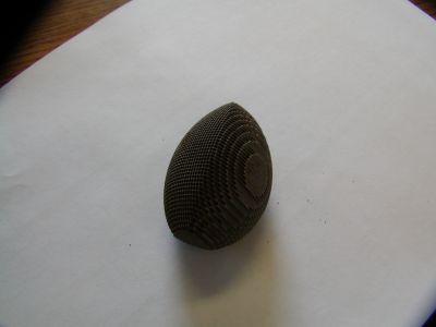

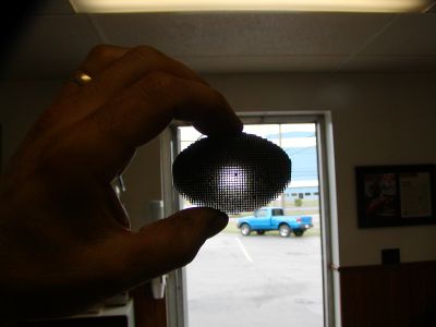

SERVICE WRITER
  • 9,123 POSTS
https://images.2carpros.com/forum/automotive_pictures/30961_P8200023_1.jpg
Merlin is on the money!!!
https://images.2carpros.com/forum/automotive_pictures/30961_P8200022_1.jpg
New version of the old thing. Not that I'm surprized!

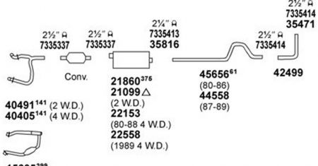

Both of us mis read. muffler was replaced.
https://images.2carpros.com/forum/automotive_pictures/30961_muf_1.jpg
I would still be concerned about the over the axle pipe being clogged. I don't know that the exhaust valves haven't been damaged from driving with a plugged converter. Plugged exhaust doen't mean it won't restart. This is already a multiple source problem, it isn't to say there may still be more than one problem remaining. Here's what I see, the problem is only after it reaches operating temperature. So I don't see a plugged fuel situation, but more of a temp related issue. Thermostatic chokes are an issue on the carbs, especially being an 1985. Those springs get weak and cause this behavior. The cannister filter and fuel filter should have been replaced as normal maintenance, What maintenance has or has not been done will throw a curve into it. There aren't too many guys out there that can accurately work with a carb from what I have seen...for what it matters.
