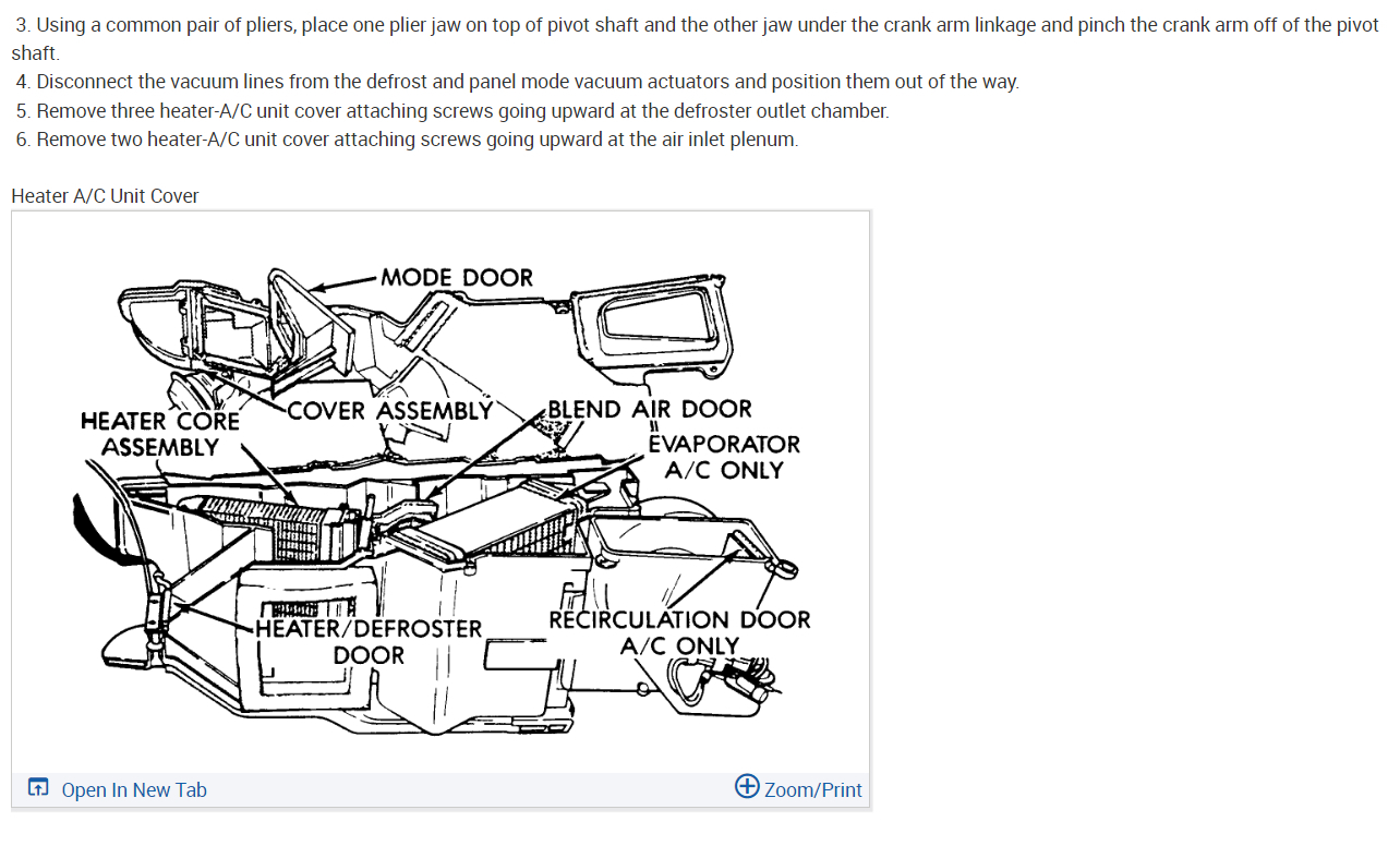

I have a 1990 dodge omni with 130,000 miles on it and the engine is a 2.2. My question is :where is the heater core located and is it an easy job to replace it for a person with a little knowledge of auto mechs. Experience?The car runs great-i am just now starting to replace all the original parts on it, I cant get rid of her because she runs good and is very good on gas. Any help would be appreciated. Thanks BOB :)

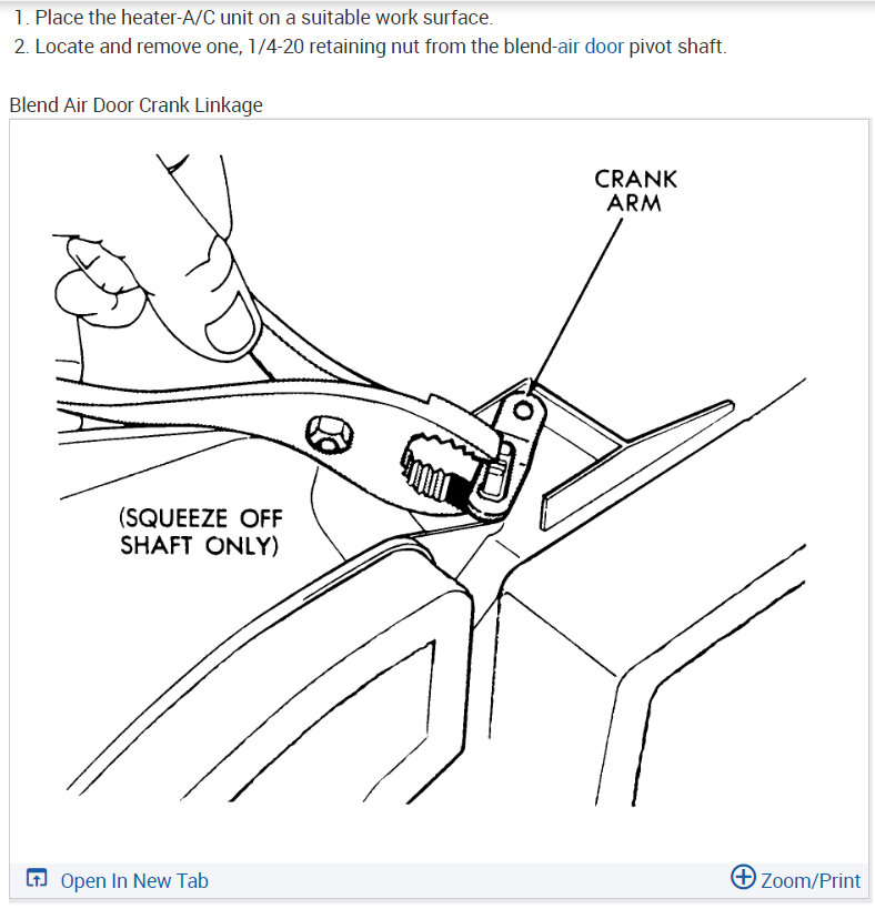

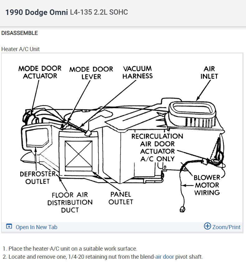

Here is the instructions and location of the heater core, it can be done with everyday tools just take your time and be organized when doing the job.
HEATER CORE REMOVAL AND INSTALLATION
NOTE: The evaporator case (Heater-A/C housing) must be removed from the vehicle first. See: Evaporator Case > Procedures
1. Remove heater A/C unit top cover.
2. Remove heater core to dash panel seal from the core tubes and remove the heater core from the unit.
3. To install, reverse the preceding operation.
