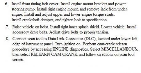

me and my dad are trying to fix my dodge neon and we have to remove the timing belt please can you give me instructions on how to remove it and how to put it back -thank you
