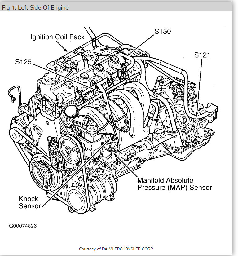

Want to have a picture where the mass air flow sensor located. Will be cleaning with CRC MASS air flow sensor cleaner.
Aug 27, 2020 at 4:15 AM (Merged)
  • 55,433 POSTS
Your car doesn't have a MAF it has a MAP sensor here is the location below. Check out the diagrams (below). Please let us know if you need anything else to get the problem fixed. Cheers, Ken
