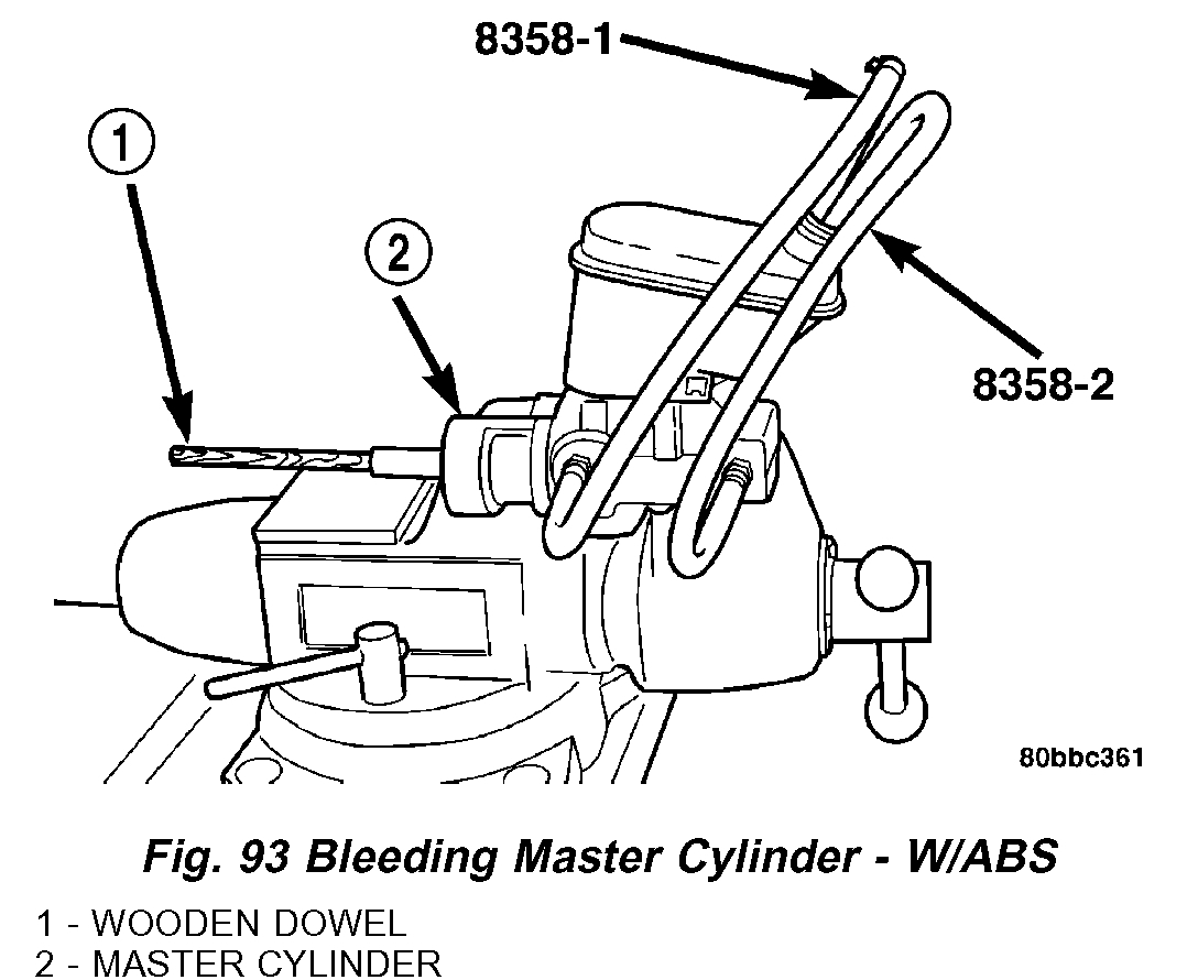

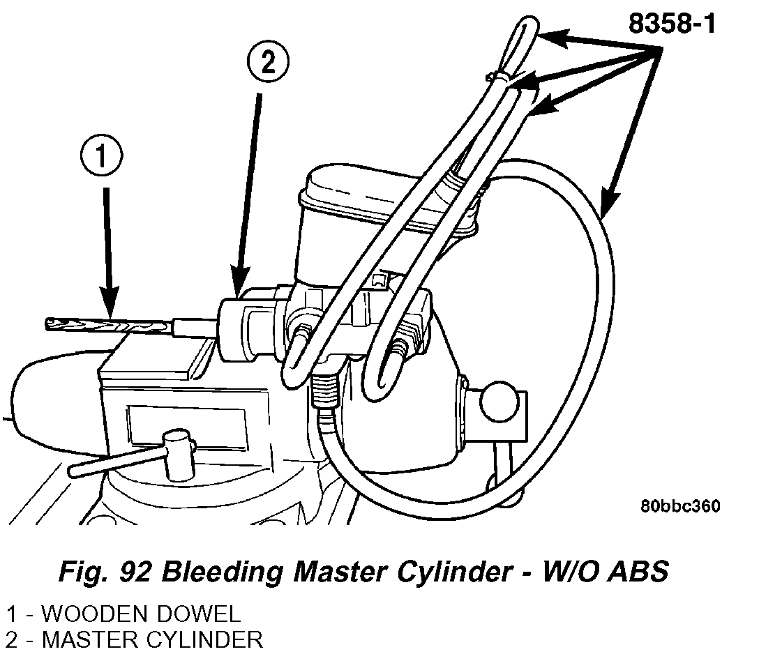

a. Attach four Master Cylinder Bleed Tubes, Special Tool 8358-1, to the four ports of the master cylinder and tighten each in place (Fig. 92). The bleed tubes for the ports pertaining to the rear brakes are made to attach to the proportioning valves screwed into the master cylinder. Position the other end of the tubes into the master cylinder reservoir so their outlets are below the surface of the brake fluid in the reservoir when filled.
pic 2
b. Attach Master Cylinder Bleed Tube, Special Tool 8358-1, to the primary port of the master cylinder and tighten in place (Fig. 93). Attach Master Cylinder Bleed Tube, Special Tool 8358-2, to the secondary port of the master cylinder and tighten in place. Position the other end of the tubes into the master cylinder reservoir so their outlets are below the surface of the brake fluid in the reservoir when filled.
3. Fill the brake fluid reservoir with fresh Mopar brake fluid, or equivalent conforming to DOT 3 specifications.
4. Using a wooden dowel as a pushrod (Fig. 92) (Fig. 93), press the pistons inward slowly applying brake pressure, then release the pressure, allowing the pistons to return to the released position. Repeat this several times until all air bubbles are expelled out of the tubes and master cylinder bore.

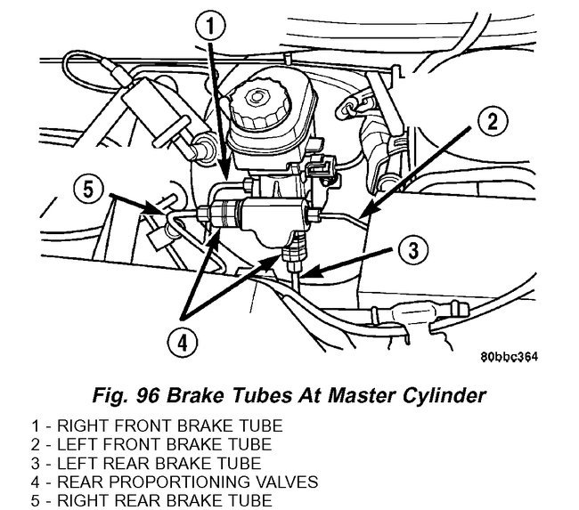

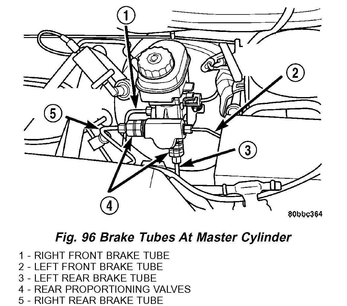

pic 3
7. Connect the four brake tubes to the master cylinder and proportioning valve ports (Fig. 96). Tighten all tube nuts to a torque of 17 Nm (145 inch lbs.).
