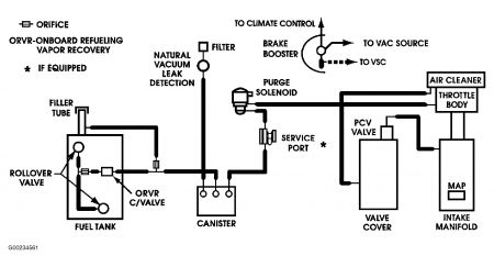

I just recently got a tune up and my car is still shaking a bit. As I was leaving they added that I am do for a coolant flush,I'm not sure what that is or how long I can last without it.

I am more concern with your shaking problem. Can you give a little more descriptive explanation to the problem. Include time of day, idle or driving, intermittent or all the time, etc. The more description you provide, the easier the diagnosis will be.

The shaking is usually noticeable in the early mornings, about 6am when taking kids to the bus stop, it shakes some during the evening while preparing to head home from work. The colder it is the harder it shakes. I let the car warm up a bit but for the most part the shaking still exists every day. It doesn't shake while I'm driving only while sitting still.

I am going to assume that the shaking you mention is the engine lopes while idling or idling erratically. A few things for you to check. 1. Vacuum leak. Check all your vacuum lines, making sure that they are all connected, no frayed or cracked lines. Here is your vacuum diagram
https://images.2carpros.com/forum/automotive_pictures/55316_neonvacuum_1.jpg
2. Leaking EGR valve 3. Clogged air filter 4. Insufficient fuel pressure There are other tests that you should do, but let's start with these first. These are the most common.
