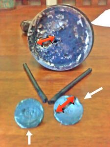

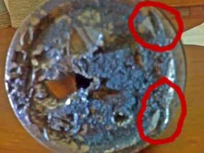

Call Todd's service center. 4316 CALL FIELD RD WICHITA FALLS, TX. 76308-2520 940-767-1399 Doesn't look like there is an abundance of shops out that way. This one belongs to a network I belong to. The timing belt is recommend to be replaced at 100,000 miles, but I have started seeing them fail from age not mileage. Yours is in that area that they have been failing at. I strongly recommend you do this as well as the waterpump regardless of the code. Should the teeth shear or the belt break, there is a fair chance the engine will have internal damage. This is an interference engine, meaning when it goes out of time, the valve and piston will likely collide.
https://images.2carpros.com/forum/automotive_pictures/30961_piston1a_3.jpg
https://images.2carpros.com/forum/automotive_pictures/30961_piston2a_2.jpg
