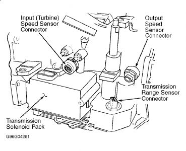

actually the trans. fluid mixed with the coolant.
installed new radiator flushed motor, trans and filter change. it ran great for a few days the it started to slip and now it wont come out of 2ND gear, still has reverse. scan for codes revealed p0700 and p0755.
Mar 24, 2009 at 7:08 PM
BMRFIXIT
  • 19,053 POSTS
Had one Saturday in the shop with the same codes replacing solenoid pack solved the problem good luck and let me know

I found the trans solenoid pack, but if i install this do i have to program it or is this already done.
Mar 26, 2009 at 6:55 PM
BMRFIXIT
  • 19,053 POSTS
Disconnect battery
Clean area before removing the old solenoid out
remove speed sensor out
remove center wiring bolt connector
remove 3 holding bolts
remove solenoid and gasket
clean gasket area
install new gasket and solenoid
reconnect battery
starter and check tranny fluid
drive safe
