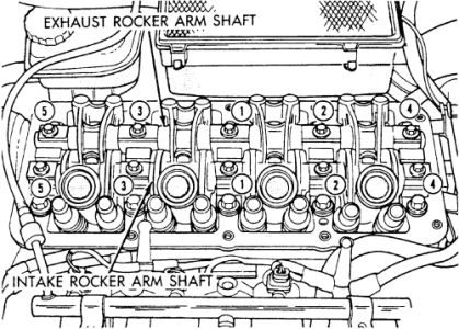

Four cylinder front wheel drive automatic.
Torque for cylinder head and rocker arms.

Cylinder Head: For SOHC engines, tighten the cylinder head bolts, in the sequence shown, to the following specifications: Step 1: Tighten the bolts to 25 ft. lbs. (34 Nm). Step 2: Tighten the bolts to 50 ft. lbs. (68 Nm). Step 3: Loosen, then re-tighten the bolts to 50 ft. lbs. (68 Nm). Step 4: Tighten all bolts an additional 1/4 turn. Do NOT use a torque wrench for this step. For DOHC engines, tighten the cylinder head bolts, in the sequence shown, to the following specifications: Step 1: Tighten bolts 1-6 to 25 ft. lbs. (34 Nm) and bolts 7-10 to 20 ft. lbs. (28 Nm). Step 2: Tighten bolts 1-6 to 50 ft. lbs. (68 Nm) and bolts 7-10 to 20 ft. lbs. (28 Nm). Step 3: Loosen, then re-tighten bolts 1-6 to 50 ft. lbs. (68 Nm) and bolts 7-10 to 20 ft. lbs. (28 Nm). Step 4: Tighten all bolts an additional 1/4 turn. Do NOT use a torque wrench for this step. Rocker Arms: 21 ft. lbs. (24 Nm) in the sequence shown in the accompanying figure
https://images.2carpros.com/forum/automotive_pictures/261618_0900c152800790d4_1.jpg
