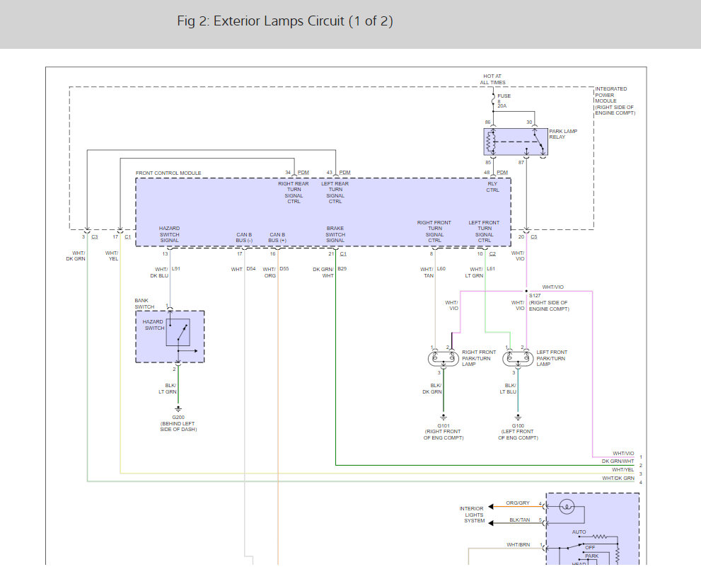

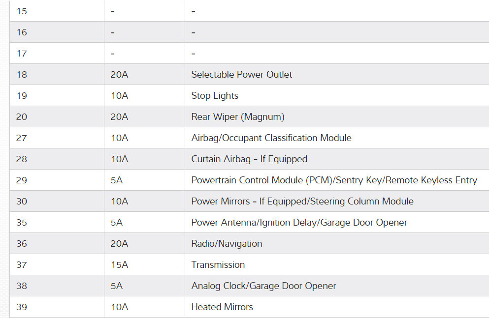

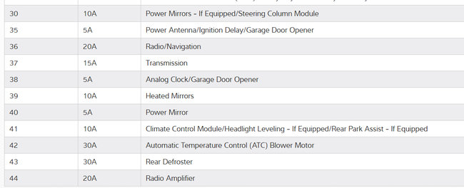

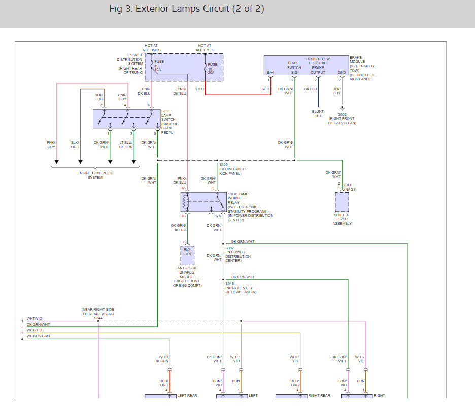

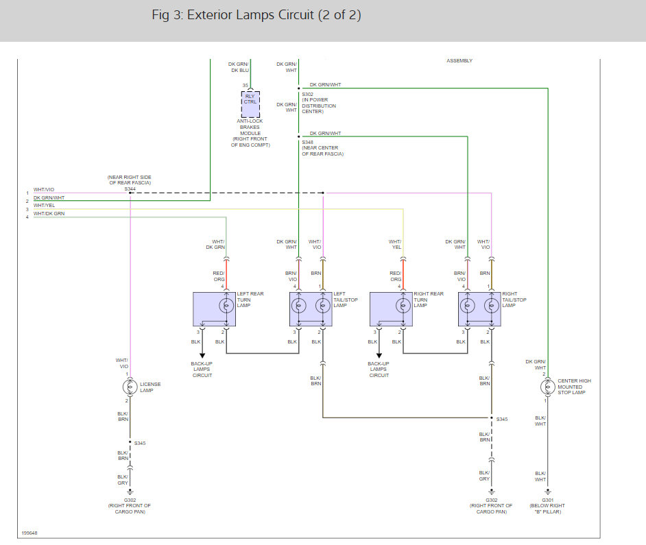

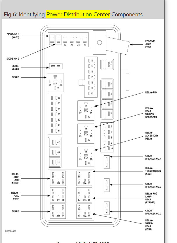

my brake lights dont. i replaced the brake switch by the pedal still nothing. bulbs are good when i take bulb out to see if there's power going there to it but there isn't any power i checked the fuse and that was still good but replaced it. and wondering if there's a relay to the brake lights?
Feb 14, 2009 at 9:04 AM
  • 75,992 POSTS

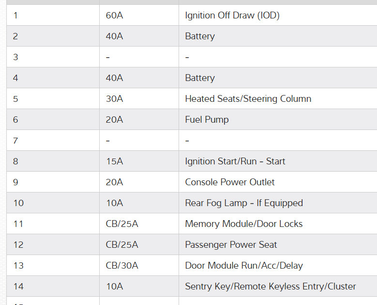

There is a stop lamp relay that needs to be checked here is a guide to help us get started with the relay location and the brake light wiring diagrams so you can see how the system works below.
Check out the diagrams (Below). Please let us know what you find. We are interested to see what it is.
Feb 14, 2009 at 9:54 AM
MAHENDRA DAHYA
Thank you for this post I had a bad relay got a new one $34.00 worked like a charm.
