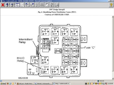

Windshield wipers stopped functioning. Have checked all fuses.Have replaced multifunctional switch on steering column.Ran 12 volts direct to wiper motor..motor did work. 1996 Dodge Intrepid

Hey! There are also 2 relays that need to be checked/tested, heres the pic of their location
https://images.2carpros.com/forum/automotive_pictures/47722_wiper_2.jpg

Most likely needs a new wiper motor, which is a pretty easy install. It will be located on the back firewall and should come off with just a few bolts. When you install the new one make sure to align it just as the previouse motor was aligned or the wipers won't sit properly.
