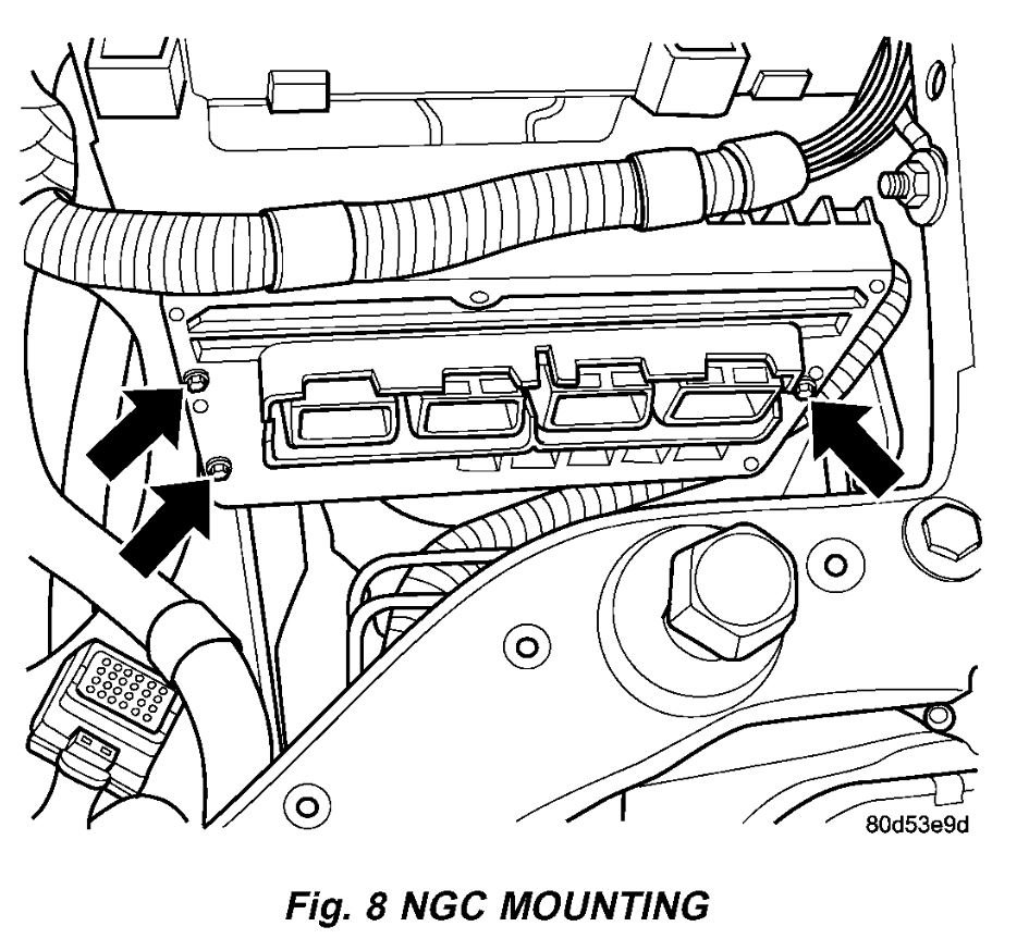

Could you tell me where the transmission control module located?
Apr 9, 2008 at 1:21 PM
BMRFIXIT
  • 19,053 POSTS
According to the manual an 03 doesn't have a separate TCU, it is integrated in the PCM, located next to the fuse box driver side (see diagram below) Check out the diagrams (Below). Please let us know if you need anything else to get the problem fixed.

I can't find the TCM in my or under the hood.
Jan 18, 2021 at 3:35 AM (Merged)
STEVE W.
  • 15,352 POSTS
There is no separate transmission control module in that car. It is part of the Power-train Control Module. To replace it requires programming a new PCM to match the car. What is the issue with the transmission that makes it act like a bad TCM?
