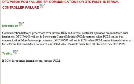

My check engine light came on. I ran a diagnostic scan and received code P0601. Int Memory Control Bad Memory Check Sum. What does this mean and how can I fix it? Is there a problem with the computer itself or is this a relatively easy repair?
Aug 24, 2009 at 9:16 PM
BLUELIGHTNIN6
  • 16,542 POSTS
you will need to have the powertrain control module (PCM) replaced.

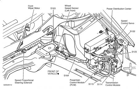

Does this mean the computer is bad? I have always known the computer as the ECM. You are referring to a PCM, are these one in the same? If not, where is the PCM located so I can replace it? If the computer itself is bad where is it located on the vehicle? Thanks, Brian
Aug 24, 2009 at 9:46 PM
BLUELIGHTNIN6
  • 16,542 POSTS
yes, the computer is faulty. ECM and PCM are one in the same . electronic control module or powertrain control module, both refer to the vehicle's computer. it is located on the left side of engine compartment.
