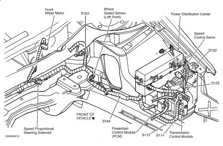

codes
P0700 & P0715
now i have change the input and the output speed sensor and i am having the same problem. now what do i check for now.

DOCFIXIT
  • 18,828 POSTS
Speed sensors not at fault P0700 means TCM reporting internal errors and must be replaced. Transmission Control Module location see figure
https://images.2carpros.com/forum/automotive_pictures/198357_Graphic_404.jpg
