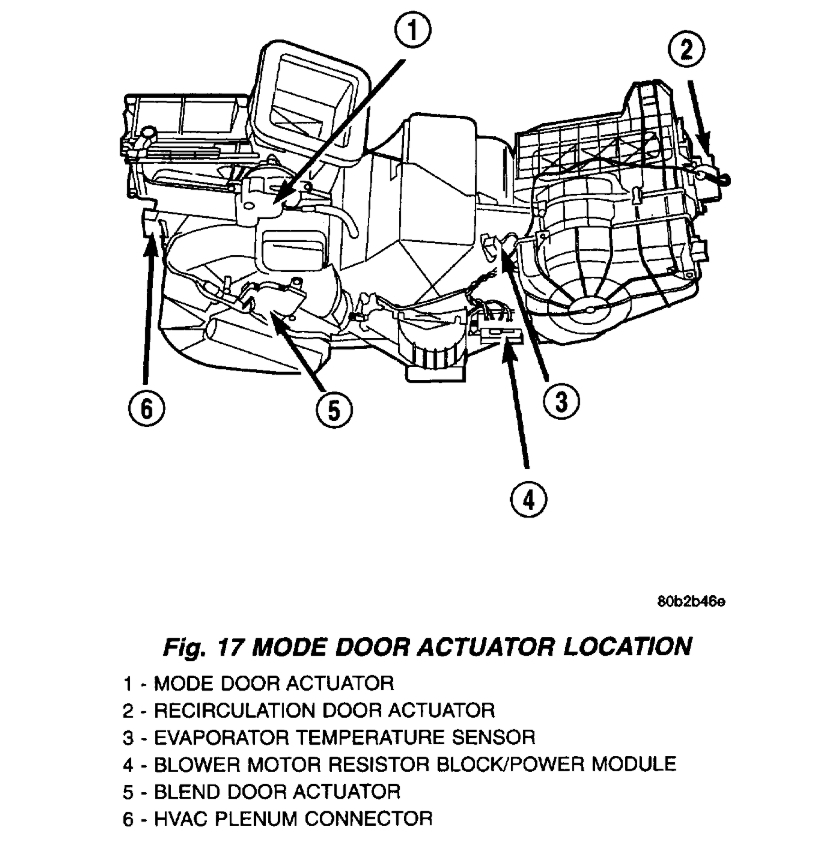

I have changed the two fuses for the hi/lo fans. I don't know what else to do. It is still blowing hot air when I set it to cool air. What do I do???
-Marco
Sep 8, 2009 at 4:02 PM
  • 75,992 POSTS
This sounds like the temperature blend door actuator is not working here is a guide to help you see what you are in for when doing the job and diagrams to show you the location for your car below.
this guide can help as well
Cheers
Sep 8, 2009 at 4:05 PM
BAALKE1
Thanks for the guides. I fixed my car for $56.00 for the actuator. :)

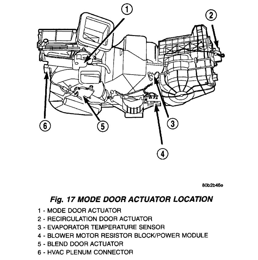

I have a 99 Dodge Interpid I have used the ATC when ever using the air. Up until yesterday the A/C has worked great. Yesterday morning it was a little cooler so I increased the temp to get some warmer air. No problem, the air was redirect to my feet and was great. Later in the day as it got hotter out I lowered the temp on the control to get the A/C going again. The air was redirected to mid level as it should, the problem is it is only blowing hot air. I know the A/C is working as the compressor kicks on and the lines coming out are cold. I know the doors redirecting the air are working since I cycled through all of them. It's just the mixing door is stuck in the hot position. I need to know where that door is and what do I need to do to repair it.
Aug 6, 2018 at 3:49 PM (Merged)
  • 110,194 POSTS
It sounds like the blend air door. It is located near the heater core in the HVAC system. Adjust the temp from hot to cold to see if it is working.

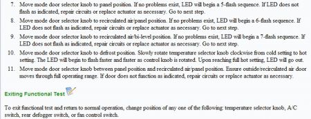

hi i recently lost my a/c in the car i had it on and it was running fine but it got cool that night and turned on the heat when i came to put the a/c back on the next day their was only heat coming out and hot just like the heater. I changed the hole heat and a/c unit and it was not that and the freon is full but now im trying to find the flap or flaps that might be jamed or malfunctionning. Could u help me out in telling me what the problem could be and were to find those traps that would open and close my hole dash is apart and its a real pain in the ... thank you very much
MERLIN2021
  • 17,250 POSTS
Do a function test like this and it will tell you where the problem is!
https://images.2carpros.com/forum/automotive_pictures/62217_AC_Test_1.jpg
https://images.2carpros.com/forum/automotive_pictures/62217_AC_Testa_1.jpg
