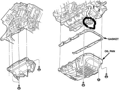

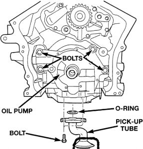

where is the oil screen located of the vehicle? Would that be an easy access into?
Thanks
Mar 14, 2010 at 6:52 AM
MATHIASO
  • 1,209 POSTS
Remove the oil pan, you will need a new gasket. it is the screen at the end the pick up tube. it is good replacing the whole pick up tube if screen is plug.
