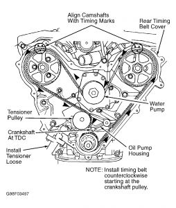

Spinning engine or if engine cranking its Not a sign of a good or bad timing
you have to remove and check if the timing belt OK
So engine is cranking
checked for spark ?
key on do u have check engine light ON ?
https://www.2carpros.com/forum/automotive_pictures/99387_Graphic1_71.jpg
