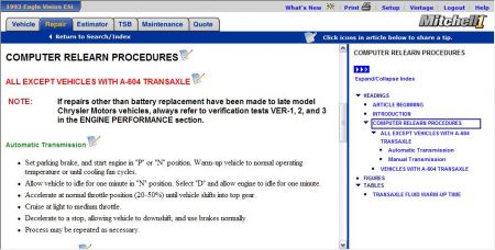

how do i reset a computer i put in my 1993 eagle vision i installed a used one in the car today and i don't have any idea how to reset it if you could help i would appreciate it very much so thank you gary

https://images.2carpros.com/forum/automotive_pictures/12900_1993_Eagle_computer_Relearning_1.jpg
