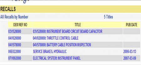

interior lights stay on long period of time and overnight

Yes there is a delay on the lights normally but currently they just stay on even while driving, I can press the button to turn them off and that will dim them a little but they will not go off, they are even staying on overnight after the the car is turned off.

the eight didit is N I removed a fuse inside on the driver side kick panel and lights have shut down in a dodge ram owners manual it is call a CCN cabin conpartment node
Mar 21, 2009 at 10:35 AM
DANSLIDELL
  • 5 POSTS
it look to be a proble with the instrument cluster

Hello - By the way, it looks like you may have some recalls on your vehicle. The dealer may fix these for free. Please contact the dealer service department, give them the VIN number of your car and have them check on these to see if they apply to you.
https://images.2carpros.com/forum/automotive_pictures/248015_Recalls_21.jpg

the instrument cluster was the problem after all my research in was a recall took me day and yet no one sent this recall

So it was the recall listed above????? Instrument board circuit board capacitor?
So now it is fixed?
