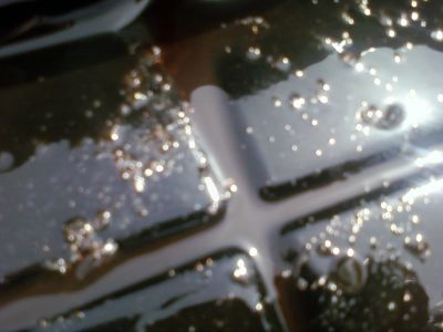

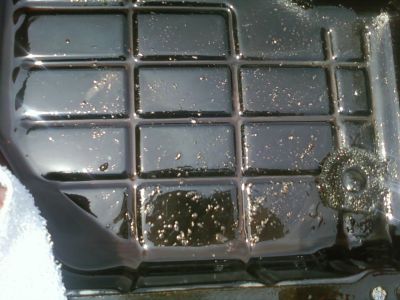

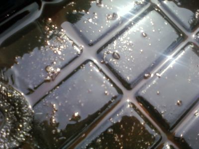

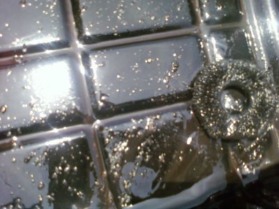

Here are pics of whats in the pan....
https://images.2carpros.com/forum/automotive_pictures/217250_SSPX0018_1.jpg
https://images.2carpros.com/forum/automotive_pictures/217250_SSPX0017_1.jpg
https://images.2carpros.com/forum/automotive_pictures/217250_SSPX0013_2.jpg
https://images.2carpros.com/forum/automotive_pictures/217250_SSPX0014_1.jpg
