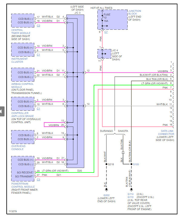

Whle replacing the motor the wires on the coding connector were pulled loose. New motor is in but problematic while idling. I need a diagram of the wiring for the connector so I can code for the problem.

I was referring to the female connector from the car for the scan tool. I think it's called the aldl connector--I found a pinout diagram in the Mitchell manual wiring diagrams that showed 5 of the 9 wires I have and placed them accordingly. 4 I left disconnected. I ran the scan. The scan indicated that the computer, (ECM?) is not processing. Current goes in, no current comes out.
It could be that all 9 wires are needed to run the diagnostic, or, the computer cannot reboot to the new motor and I'll have to take it to the dealer to get it done. I don't have that tool.

Did you try getting codes with the ignition switch? Check out the connector wiring diagrams below.
"ALDL" stands for "Assembly Line Data Link". The wider side of the connector is pins 1-8. The narrower side is pins 9-16. I don't see a keyway so hopefully you can figure these out from the five wires you have already. Cavities 1, 3, 9-13, and 15 are not used. Some of the blank pins are used at the discretion of the manufacturer for their equipment. Certain pins are standardized among all car brands per federal mandate. If you find different wire colors, ask for a photocopy from the correct manual from a friendly Dodge dealer. I don't have any Caravan manuals newer than a '95. These connectors started in '96.
Check out the images (Below). Please let us know what happens.

Thanks, that's more info than I was able to get from the condensed library Mitchell reference. The Dodge dealer did a reboot to the computer and the Durango is running.
