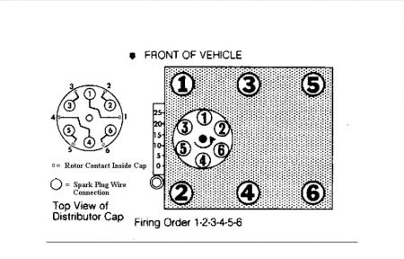

can you tell me how much pressure the fuel pump should be putting out? And what is the firing order of the plugs, and lastly what should the timing be set at? Thanks Sky Dog

Need to know if 3.0l or 3.9l

Dakota firing order. Sorry doc, didn't see you. The picture is 3.0.
https://www.2carpros.com/forum/automotive_pictures/170934_dakota_firing_order_1.jpg
