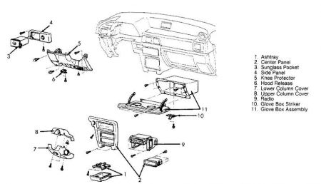

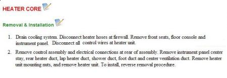

1992 Dodge Colt 4 cyl Front Wheel Drive Automatic
just need a brief explanation on how to replace the ehater core? Im a little lost on where it is and how to replace it NEED AN ANSWER SOON.. WINTER IS COMING!!! thanks guys!!

https://images.2carpros.com/forum/automotive_pictures/261618_Noname_1209.jpg

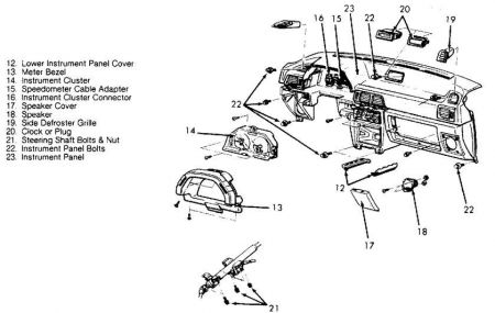

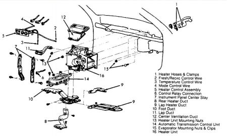

yes it helps lots, do you have any pictures you can possibly find to show?? thanks a lot

https://images.2carpros.com/forum/automotive_pictures/261618_Noname_1210.jpg
https://images.2carpros.com/forum/automotive_pictures/261618_Noname2_355.jpg
https://images.2carpros.com/forum/automotive_pictures/261618_Noname3_136.jpg
