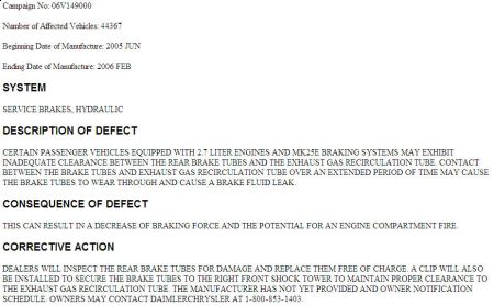

Does the brake hose get restricted or collapsed when turning? Compare the two sets of pads between the two front wheels. IF one side is worn more, look for a caliper or brake hose problem on that side. Caliper may be loose? Not sure what you mean by there is steering play when turning left. Call the service dept at the dealer regarding a saftey recall for this:
https://images.2carpros.com/forum/automotive_pictures/30961_recall_1.jpg
