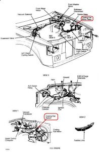

The Radiator Fan will not come on when car gets hot. I already replaced the fan motor but it still Isn't working. I checked for power and none is coming to the fan. So I am wondering if it could be a senser or a relay, or something else? And if it is a senser or relay where is it located?

Check out your cooling fan motor relay, located on the left shock tower. If it's OK, suspect faulty cooling fan switch (pictured below).
https://images.2carpros.com/forum/automotive_pictures/261618_Noname_615.jpg
