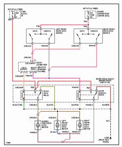

I have a '95 Dodge Grand Caravan, 3.3 liter engine, 185k miles. The door locks (all of them) suddenly engaged and would not unlock. If I remove the fuse, they will all release. Upon reinstalling the fuse, everything returns to normal for a couple of unlock cycles, but then they will return to the same behavior. And by the way, this happens under all locking operations (either through any door lock switch, or through the autolock feature based on speed).
I can hear what I think is the lock relay engage behind the center console, and normally I will hear the relay actuate briefly and release. Under this failure condition, I can hear the relay engage, but then I don't hear the normal "release" sound after all of the door lock solenoids engage. Bad relay (arced contacts)?

I would investigate a broken wire, intermittently making contact, check the wires going thru the drivers door, to the fuse block and relay...were they bend is were they break!

However, not sure how a broken wire on ONLY the driver door would prevent ALL other lock switches from opening the locks. Are you saying a broken wire in the driver door is actually somehow shorting and providing a continuous "lock" signal to the relay? I think my son may have been leaning on one of the power locks before this happened.

The drivers switch is the master!

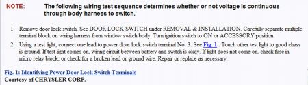

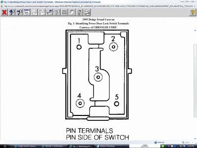

This is for Roddi from the Chrsler corp...
http://www.2carpros.com/forum/automotive_pictures/62217_Locks_copy_1.jpg
http://www.2carpros.com/forum/automotive_pictures/62217_LocksConnector_1.jpg
Do these tests and you will probably find what I said is wrong...Other pinpoint test invovle the Body Control Module...much more expensive, and more extensive testing! And if you can't give good advice, don't give any!
