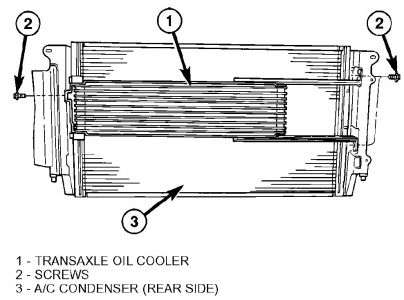

Is there a connection between the radiator and the transmission? I recently had the radiator replaced and 30 minutes later the transmission went out. I was wondering if the transmission was affected when the radiator was replaced.

There is an internal cooler in the radiator for the transmission. The cooling lines attach to the radiator.
What does the fluid look like in the transmission?

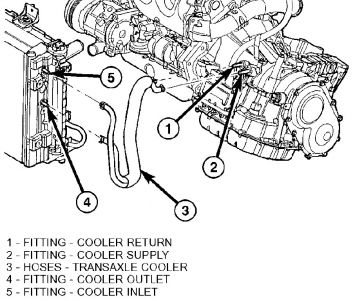

I have to recant my statement. On this particular one the cooler is separate from the radiator.
https://images.2carpros.com/forum/automotive_pictures/30961_1co_1.jpg
https://images.2carpros.com/forum/automotive_pictures/30961_1co1_1.jpg
I think this is more of a case of odd timing, a poorly designed transmission and a lack of maintaining the tranny.
