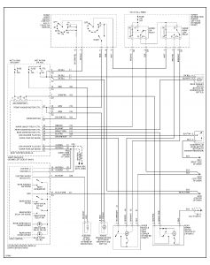

my rear wiper mtr is not working i have power to plug at motor switch lights up in both positions,removed and replaced mtr still not working,is there a relay or something i am missing,plug is 3 wire at mtr,any help would be appreciatted.

Check fuse # 6 20A and fuse # 9 15A
behind left side of dash fuse box
check for a good ground at the motor

cant see it let me know i will email it
https://images.2carpros.com/forum/automotive_pictures/99387_wiper_1.jpg
