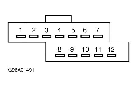

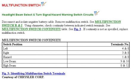

I don't think the ignition key has anything to do with your problem, except the fact that it is located close to the turn signal switch. I believe your problem is within the multi-function switch. Here is to test it.
https://images.2carpros.com/forum/automotive_pictures/55316_98caravanmfs_1_1.jpg
https://images.2carpros.com/forum/automotive_pictures/55316_98caravanmfs_2_1.jpg
https://images.2carpros.com/forum/automotive_pictures/55316_98caravanmfsfig3_1.jpg

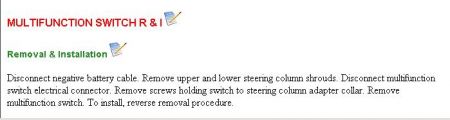

[quote]I did end up buying a turn signal switch for my 1998 Caravan, how difficult is it to replace it? Does the wheel need to be pulled. I searched everywhere for instructions but can not find any.[quote]
MULTIFUNCTION SWITCH R & I
Removal & Installation
Disconnect negative battery cable. Remove upper and lower steering column shrouds. Disconnect
multifunction switch electrical connector. Remove screws holding switch to steering column adapter
collar. Remove multifunction switch. To install, reverse removal procedure.
