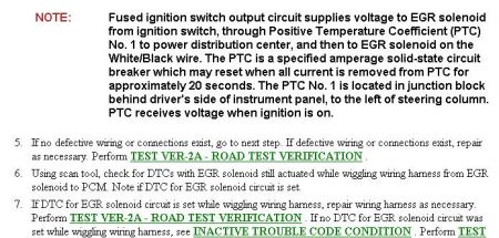

I recently replaced my alternator and had previously replaced the EGR valve. then it began a loud whine, leaking some type of fluid and transmission failed causing me to have it towed. Transmission was rebuilt by a trusted mechanic but the "Service engine soon" light now is on and I can't get it to go out using my OBD scantool. I think the loud whine is an idler pully bearing, I am losing power stearing fluid too though. The code 403 shows up when I check the OBD II but I am not sure where to start looking for proglems now.
Feb 22, 2009 at 12:05 PM
ZACKMAN
  • 4,202 POSTS

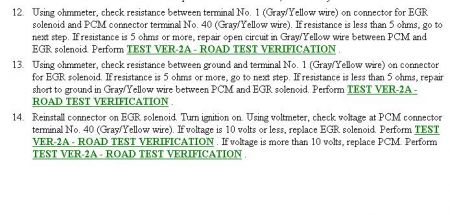

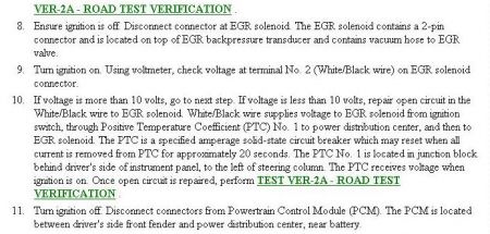

403 is for EGR Solenoid circuit. It does not necessarily mean the EGR valve, rather the its circuit to the PCM. Start with this diagnostic.
https://images.2carpros.com/forum/automotive_pictures/55316_98caravan403_1.jpg
