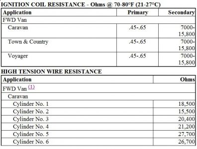

You are on the right path to check the fuel pressure. I also suggest that you check the resistance of the coil pack for each cylinder, and to check your timing belt. Just to be sure that it has not jumped a tooth.
https://images.2carpros.com/forum/automotive_pictures/55316_98caravancoil_1.jpg
