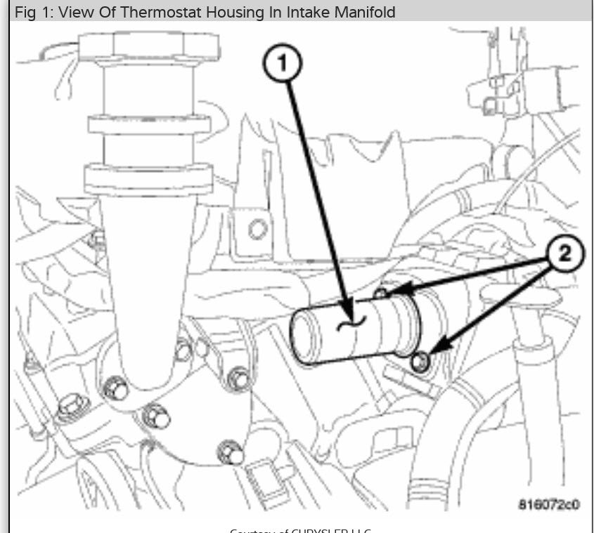

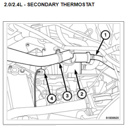

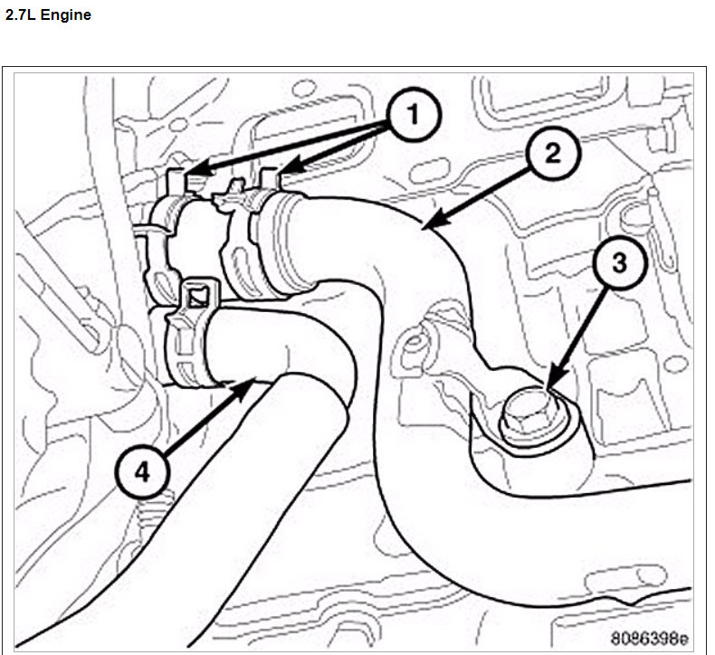

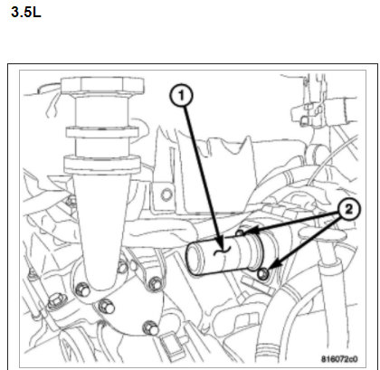

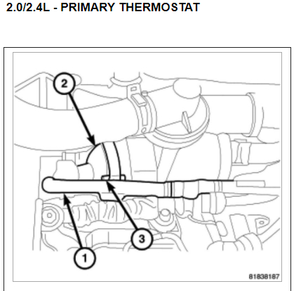

There is a primary and secondary thermostat in the 4 cylinder engine. Here is a guide to help you see what you are in for when replacing the thermostat.
and
https://www.2carpros.com/articles/coolant-flush-and-refill-all-cars
Here are some diagrams (below) of the thermostat location in all three engine (below).

should be where upper radiator hose connects to radiator on intake manifold. I have included a picture of it. See picture.
