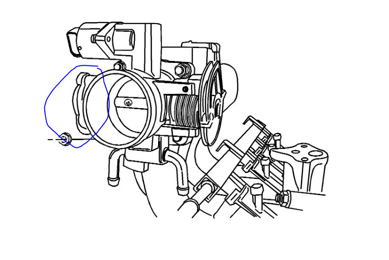

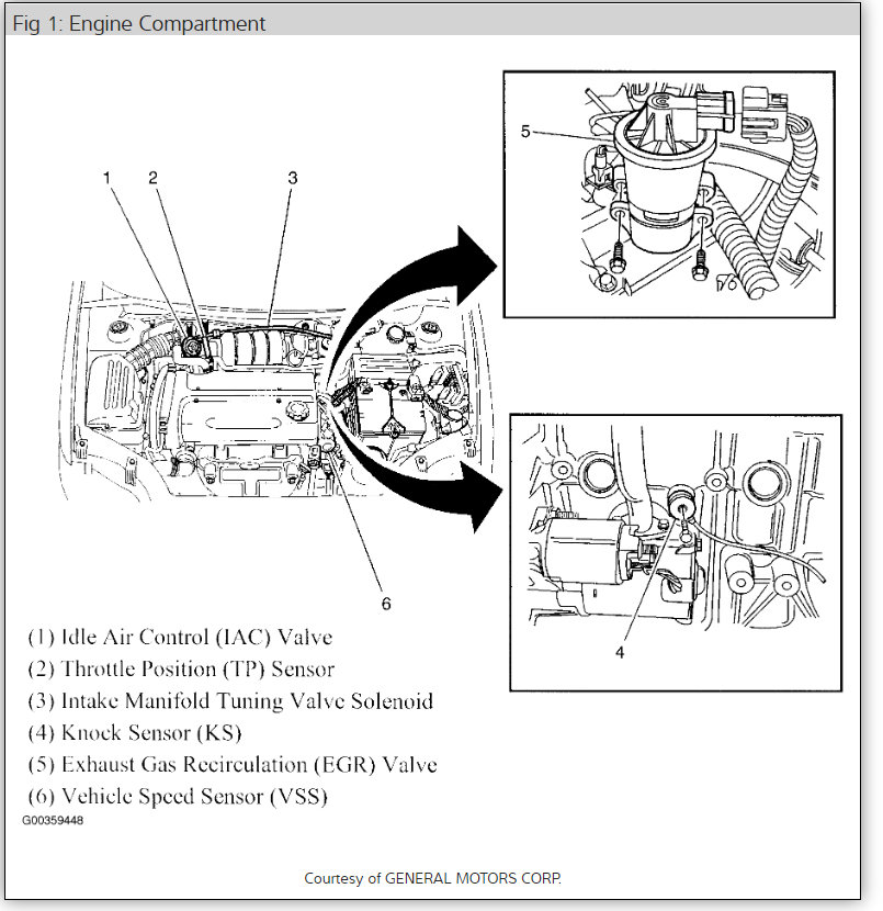

Where is the throttle body position sensor located?
Nov 26, 2020 at 12:42 PM (Merged)
Good afternoon,
I attached a picture for you. It is number 2 in the picture. It is on the throttle body itself. Check out the diagrams (Below). Please let us know if you need anything else to get the problem fixed.

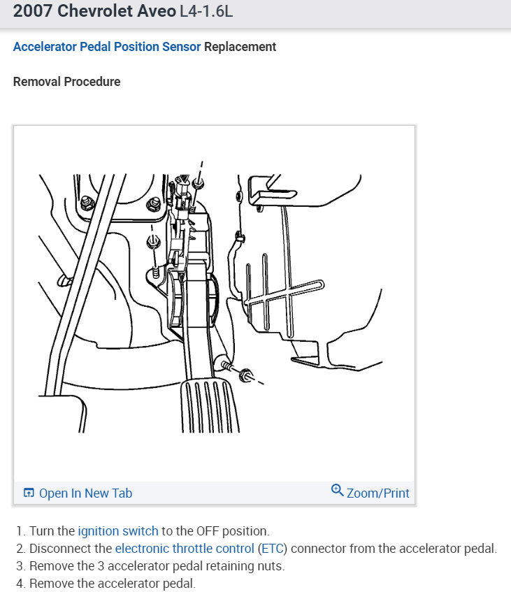

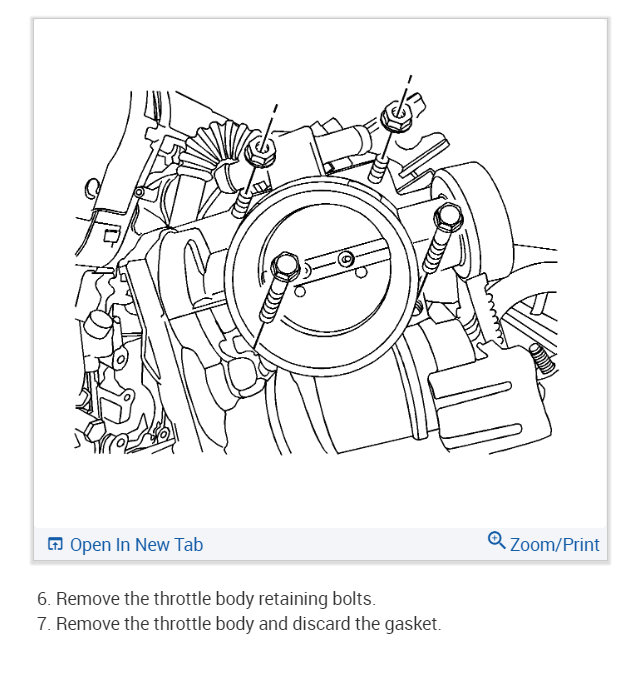

I had got a diagnostic reading on my car to figure out the problem on my car its said the tps sensor so i went to my local auto parts store ordered the tps for my car and now i am trying to replace this part. Everything i have searched tells me the tps i am looking for should be on top of the engine or near the throttle body. I have taken the throttle body off thinking maybe it was located near or of sight but i am still not finding its location. Please help :) I seen on multiple cars the location on several different types of cars and trucks but on my aveo i can not find it.
Nov 26, 2020 at 12:43 PM (Merged)
  • 75,992 POSTS
The throttle position sensor is inside the throttle actuator do you mean throttle pedal position sensor that is located at the gas pedal pivot. Here are guides and diagrams below to help explain what you are looking for.

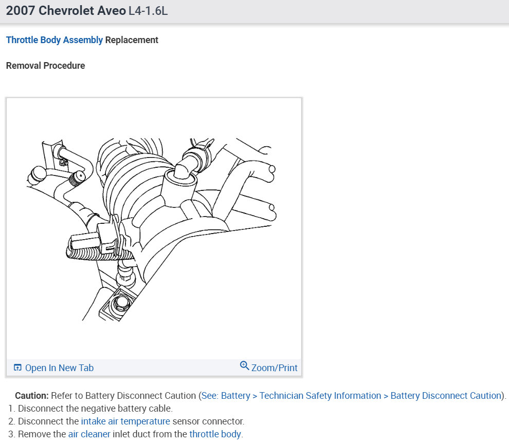

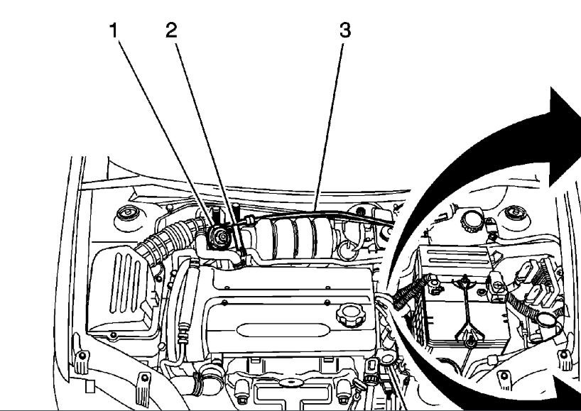

where can I fond the throttle positioning sensor on a 2007 chevy aveo5???
MHPAUTOS
  • 31,937 POSTS
Its on the throttle body assembly, there is a pic below but it in not that clear sorry.

Need to locate throttle position sensor
on the throttle body unit on the end of the intake manifold

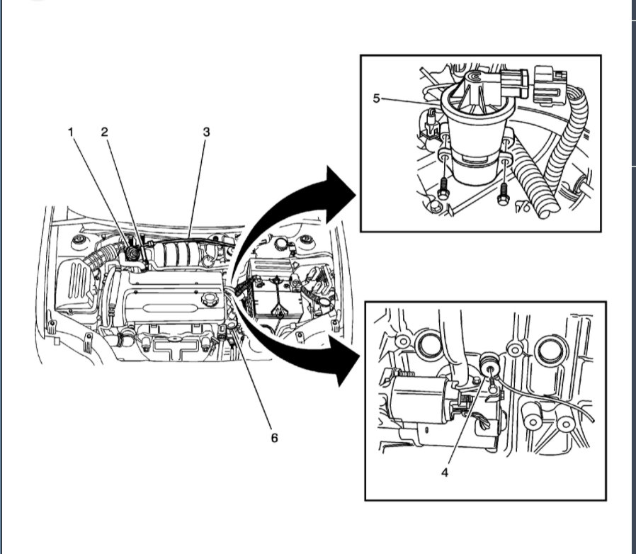

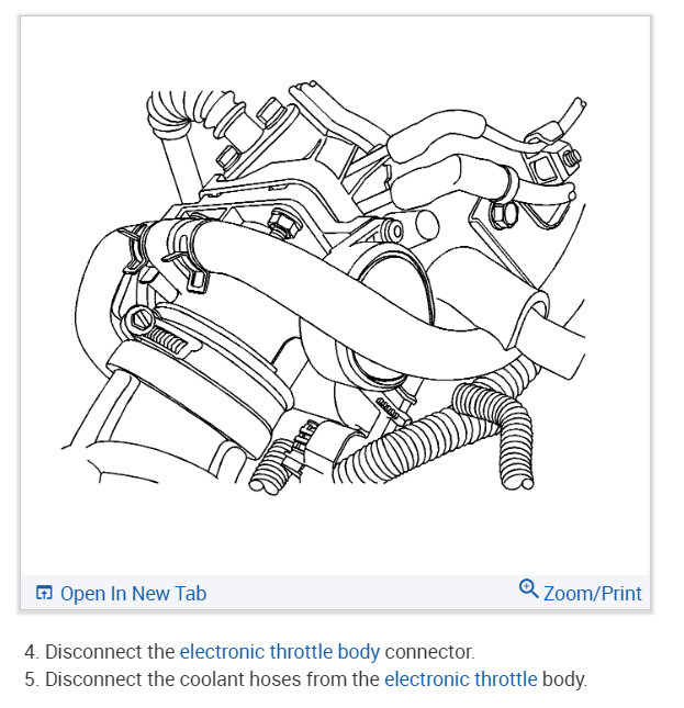

On my Aveo it looks like the throttle position sensor has a plastic cover over it with metal tabs. Is that what I would have to remove to replace the sensor? Is it easy to remove without having to remove the whole assembly the sensor is on?
Oct 21, 2021 at 7:52 PM
What is the year make and model?
Oct 22, 2021 at 3:45 AM
COOLOLDS85
  • 173 POSTS
2010 Chevrolet Aveo 1.6.
Oct 22, 2021 at 6:39 AM

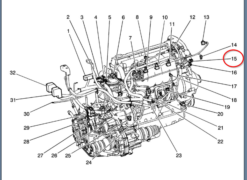

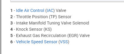

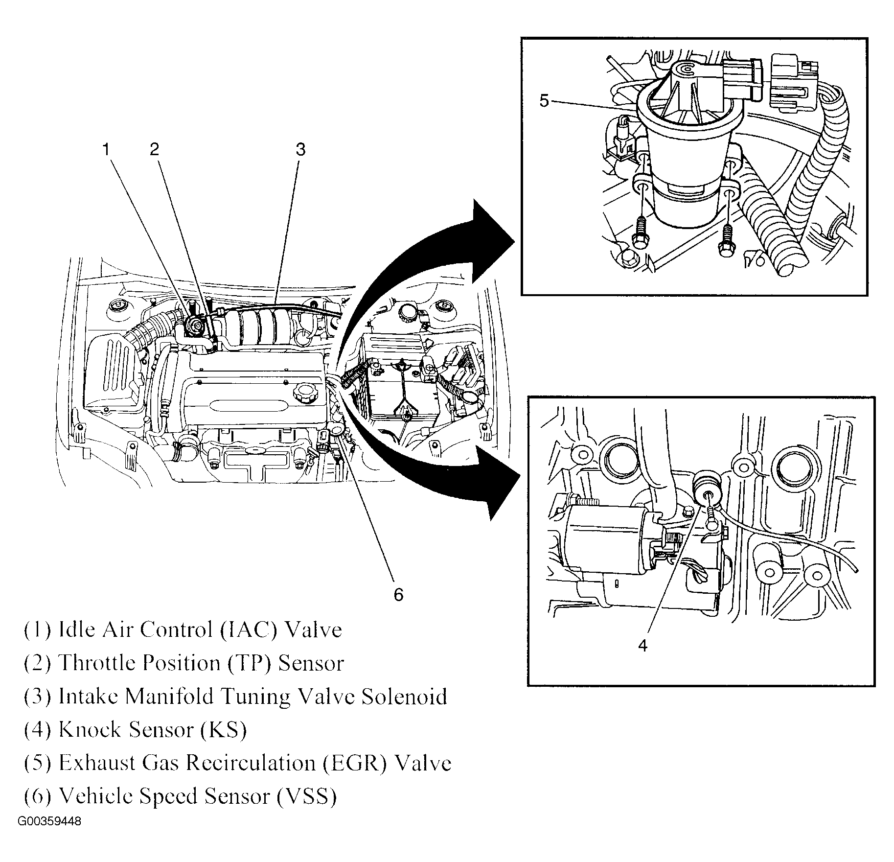

Just to jump in and see if I can help. I am attaching the location views of where this sensor is on this engine.
We don't show a plastic cover over it but that is possible as the manuals are normally not that detailed.
Please see the info below and if you can get some pictures of what you are looking at, that will help us determine the best way to remove it if this doesn't give you what you need.
Thanks
