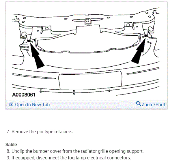

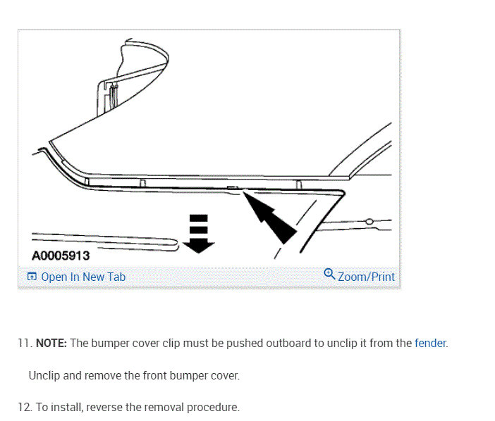

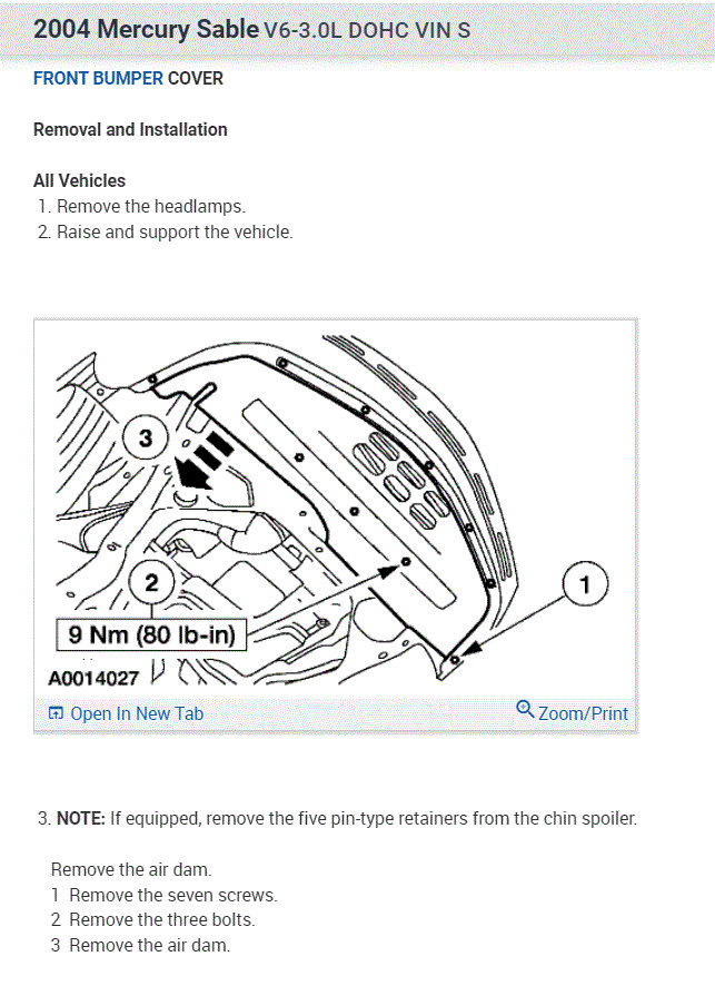

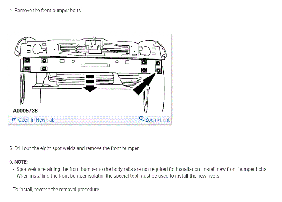

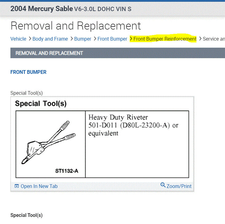

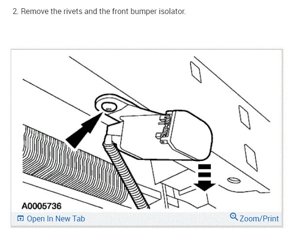

Do you have any instructions on removing the front bumper? Thanks again.
Apr 6, 2022 at 10:46 AM
  • 110,194 POSTS

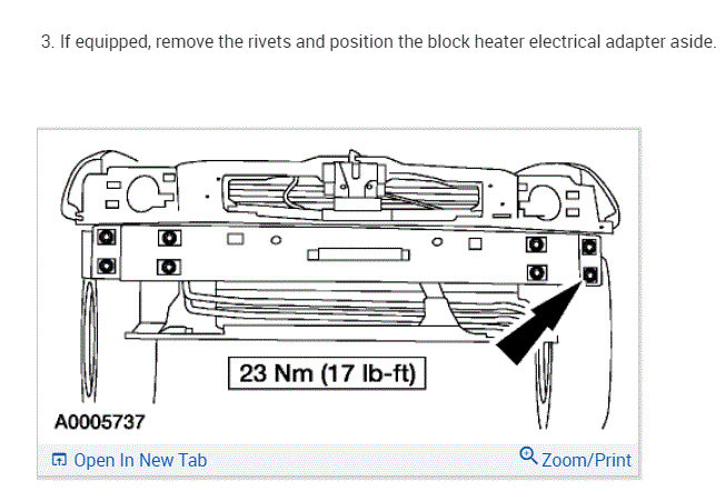

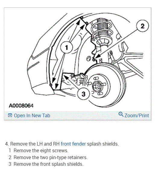

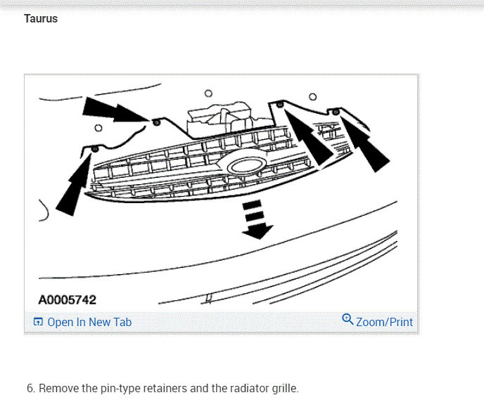

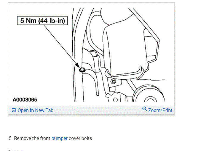

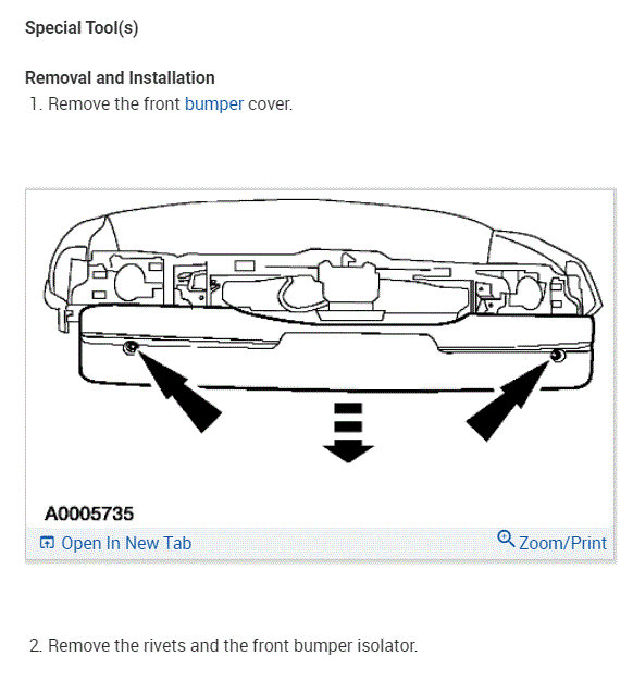

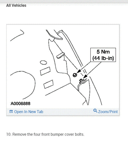

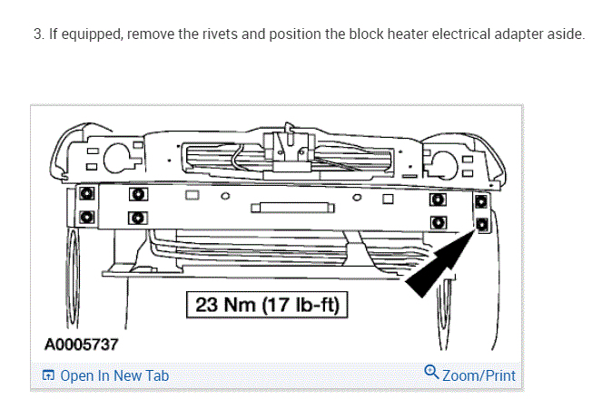

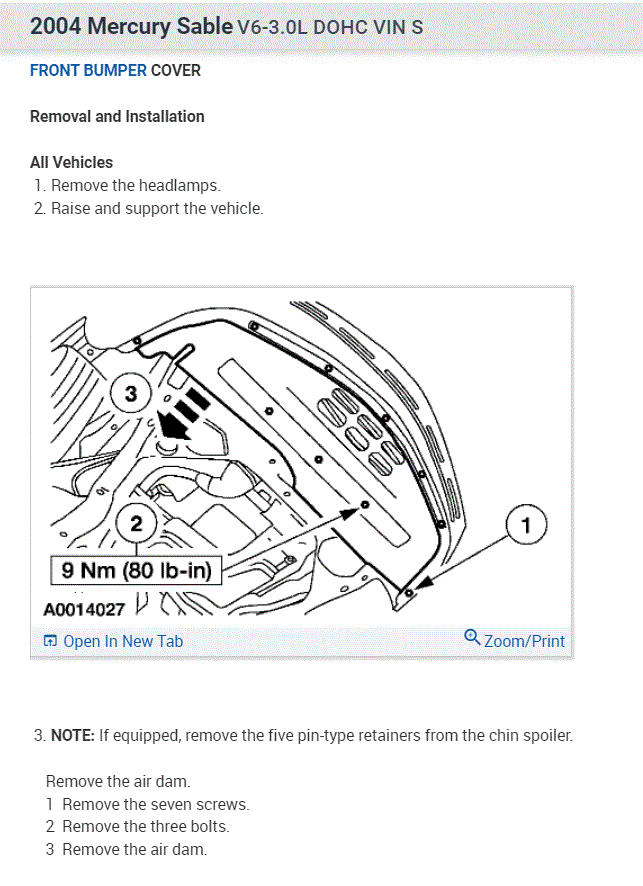

I would be happy to help. On this vehicle, there is a bumper cover and then the primary bumper. If it is the primary one needing to be replaced, the cover needs to be removed first.
I will attach the directions below for both procedures.
Let me know if this helps.

Since you referred to the front bumper, are you trying to remove the AC condenser? If that is the case, the bumper cover will need to be removed and not the main support.

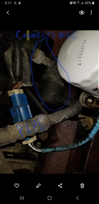

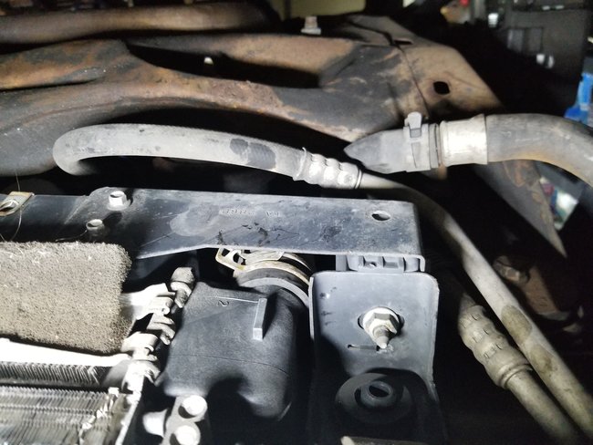

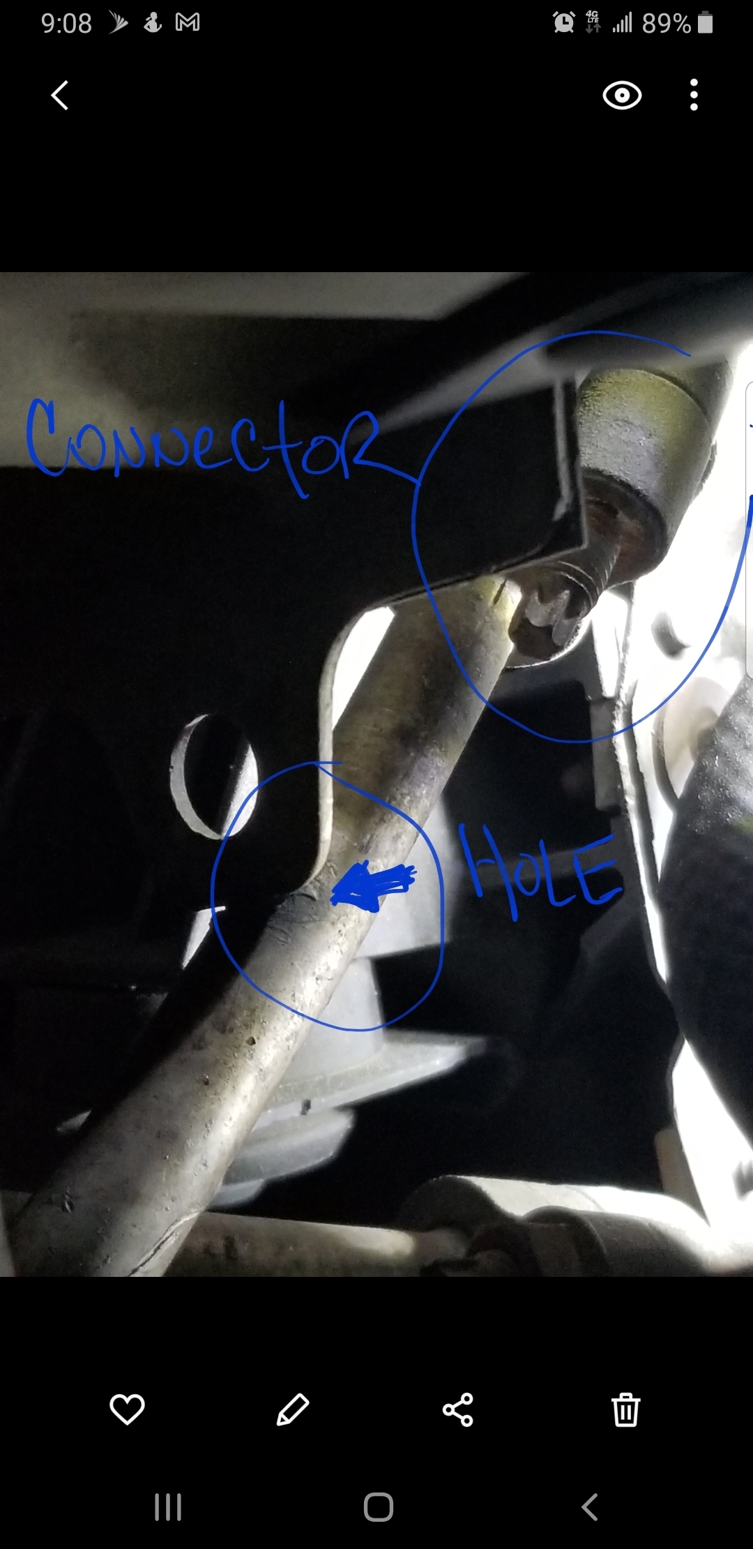

I found a hole in the A/C line under the front passenger side under the bumper. It looks to connect to the A/C Receiver Drier/Accumulator. I'm wondering if the connector I circled is removable from that section. For some reason when I upload it flips the photo.
Apr 18, 2022 at 12:18 PM
  • 110,194 POSTS
It appears to be removable because it is bolted on, but I am really struggling to determine what it goes to. I'm sorry.
Apr 18, 2022 at 2:21 PM
NYCENT
  • 15 POSTS

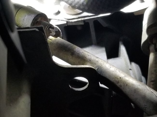

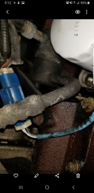

I traced the line and it's connected to the small round part with the sensor on top. From there it connects to the side of the A/C compressor. I have to track down where the other side connects to and if there are any disconnect points. The connector with the nut I tried to pull it apart once the nut was removed but it didn't separate. Do I need a special tool to pull it apart? I will try to get some more images.
Apr 20, 2022 at 6:21 AM
  • 110,194 POSTS

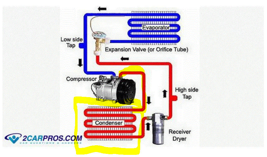

It sounds like you are referring to the high-pressure switch. As far as the pics, once the retainer bolts are removed, it will come apart. If possible, tap around where it mounts with a light hammer or better yet, a rubber mallet.
Now, I attached a pic below. It shows what each component connects to. I highlighted where I believe you described, between the compressor and condenser.
Take a look at the pic and let me know if it helps.
Also, make sure that it is running to the compressor. I'm trying to remember where the pressure sensor is located, and I can't picture it near the oil filter.
See pic below.
