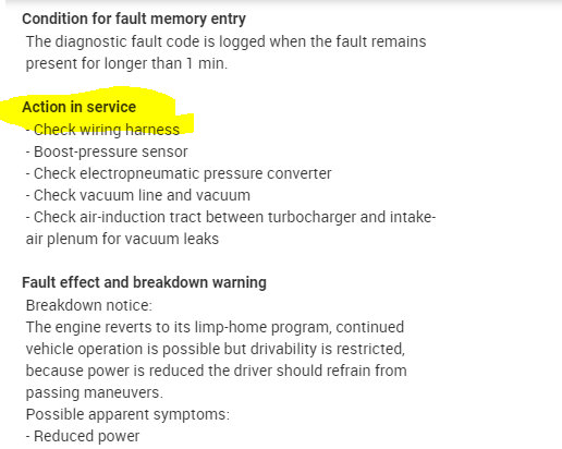

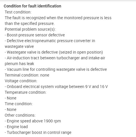

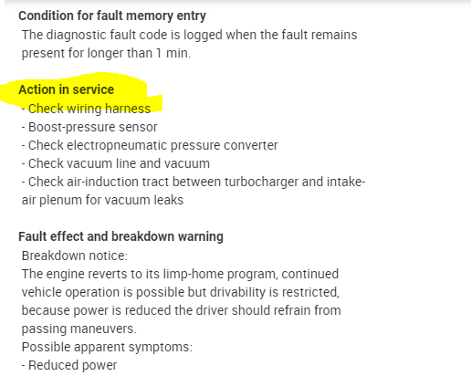

The purpose of the diverter valve is to redirect boost away from the intake when it isn't needed, so no to the transmission and yes to the charge air pressure control. However, I don't feel that is what would set this code.
The code would likely be the result of an issue with the boost pressure sensor, the wastegate valve is stuck open, a vacuum supply to the wastegate valve, an electrical issue, or a vacuum issue in general.

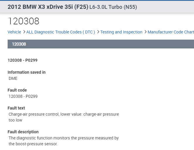

I need to know the correct engine size. Did you mean a 3.0L engine because a 2.0L wasn't an option?
If it is the 3.0L, I attached the description of the code below and possible causes. Take a look through them and let me know if they help. Additionally, if I have the wrong engine size, let me know.
