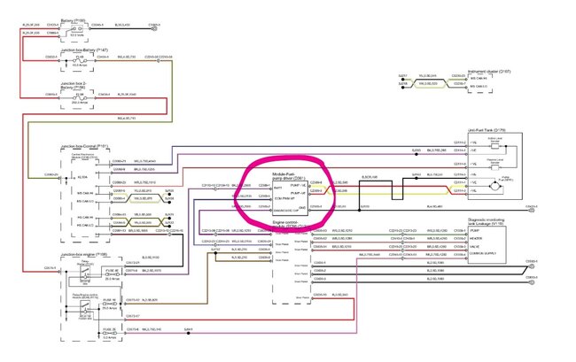

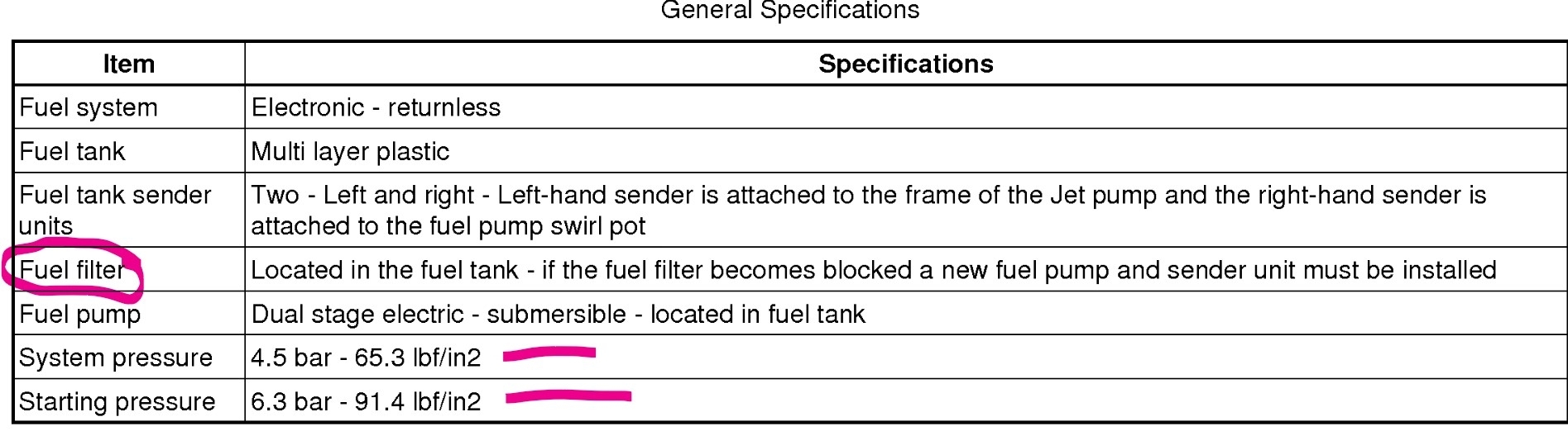

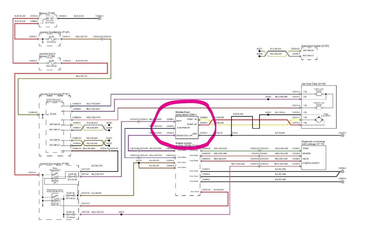

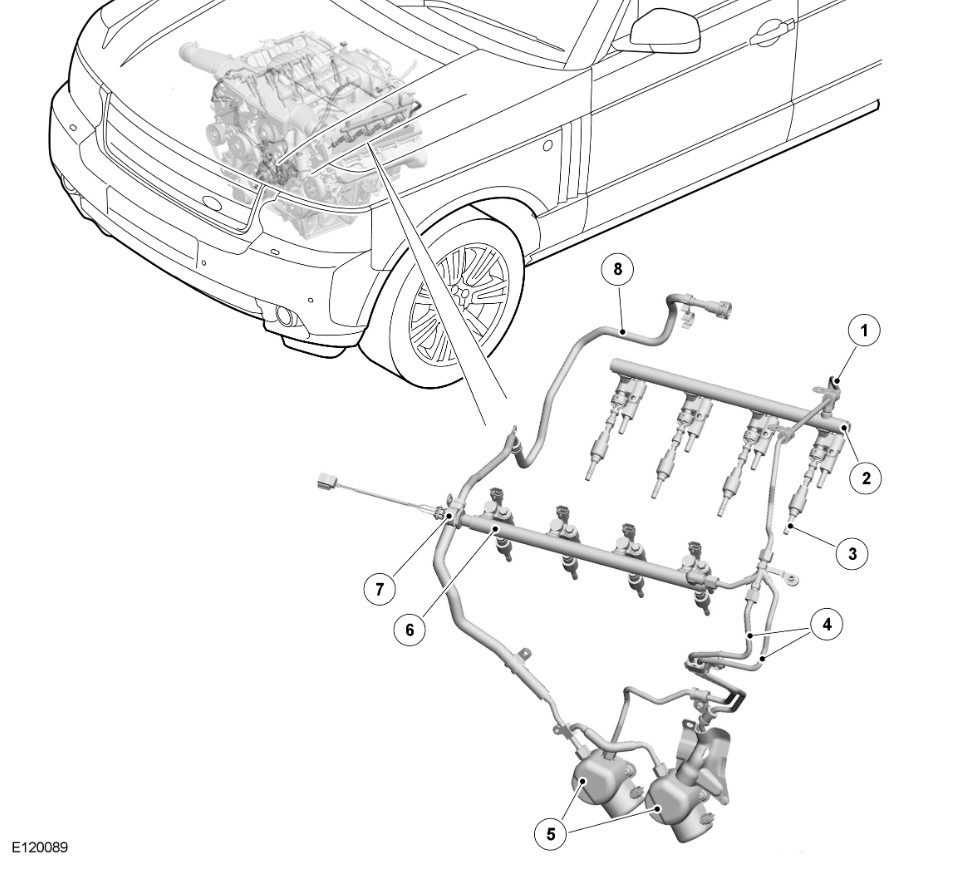

The fuel filter is part of the fuel pump module and is replaced with the pump. To get to it you need to remove the back seat and remove the access plate. Then use an unlocking tool to remove the lock ring. Disconnect the connection and lines and remove the line and then the pump. Reverse the process to install the new pump. Before you do that, I would test the fuel pressure at the feed under the hood. The prime pressure should be around 90 PSI. If you have that then see how fast, it will pump fuel into a container. If it's clear and flowing good and meets pressure, then it's likely not the filter or pump. If you get no pressure or low flow the next place to look is the fuel pump driver module. For that you will need a scan tool that can activate the pump module.

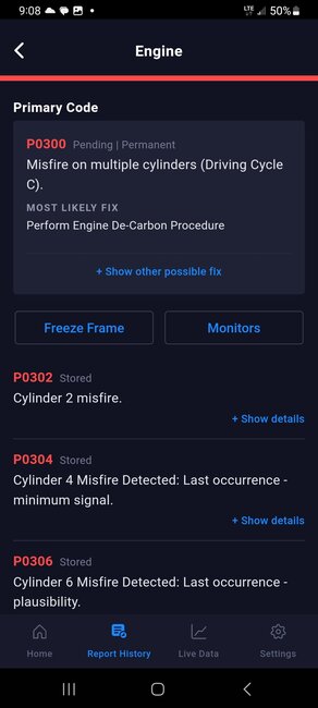

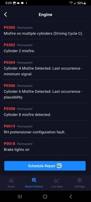

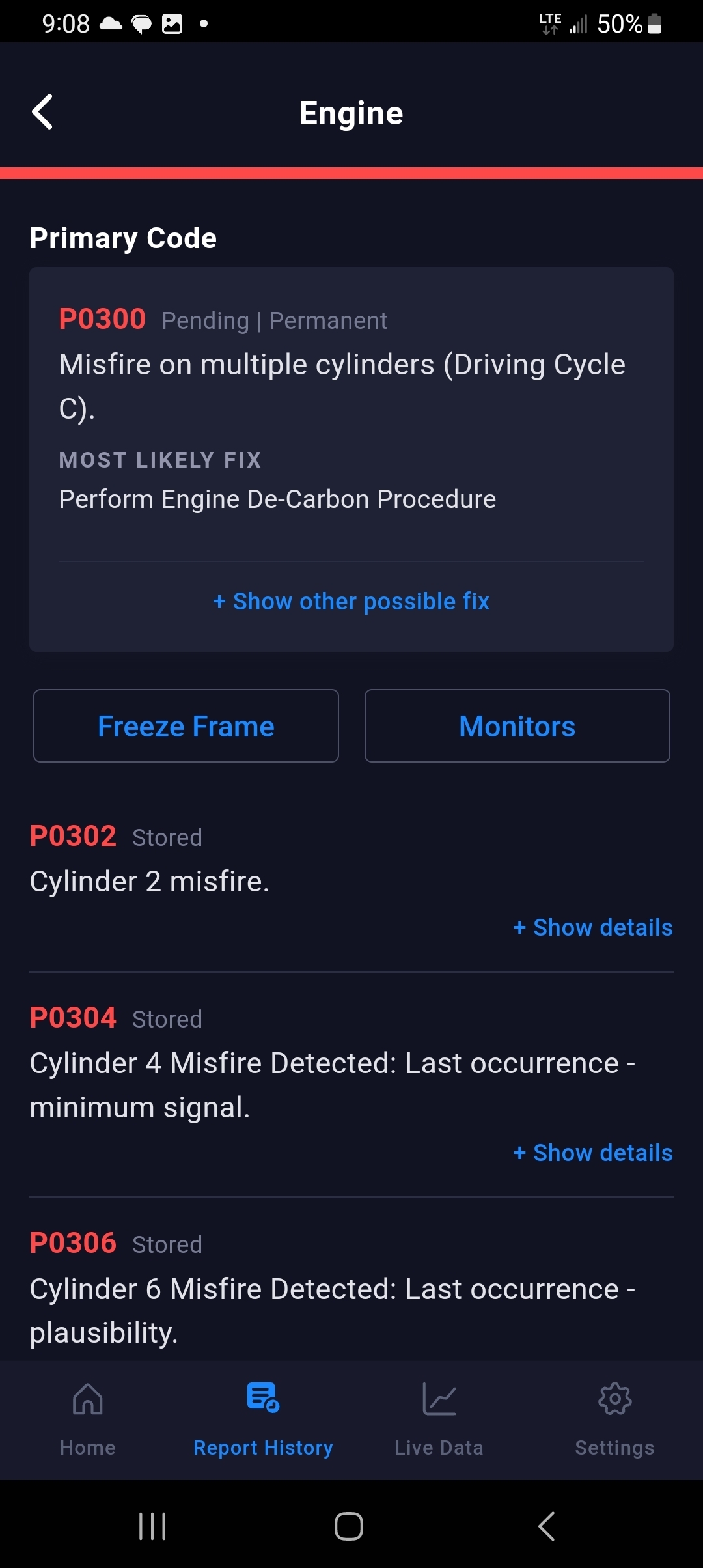

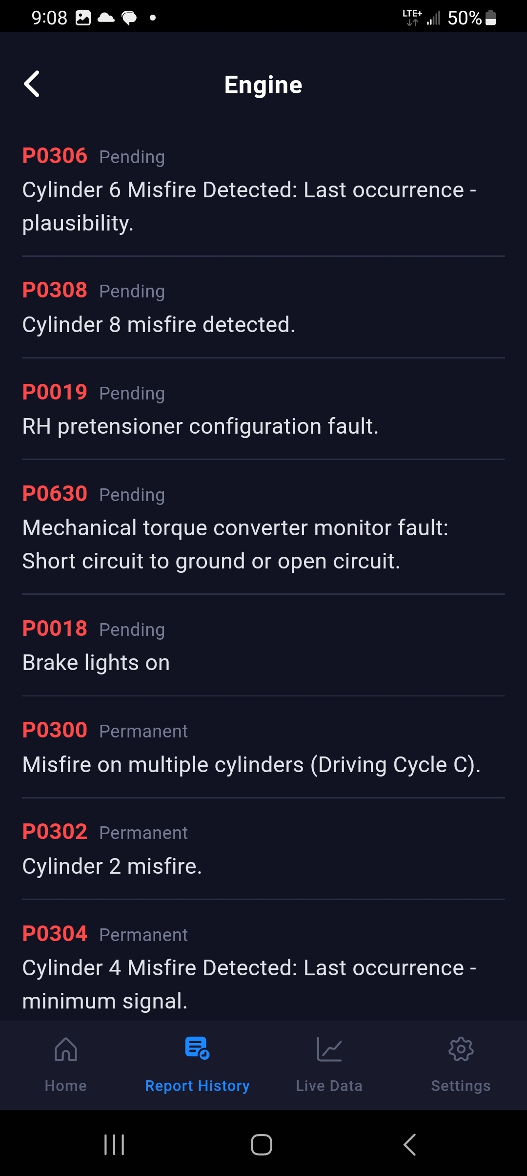

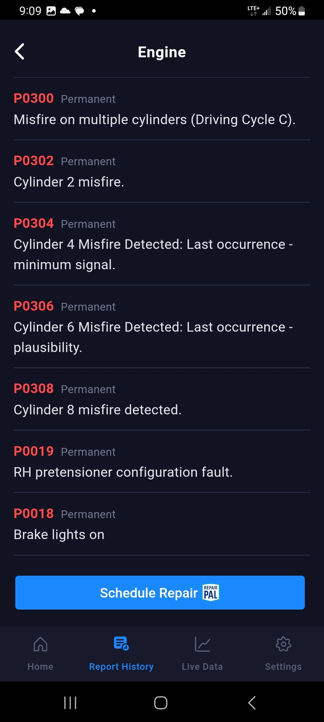

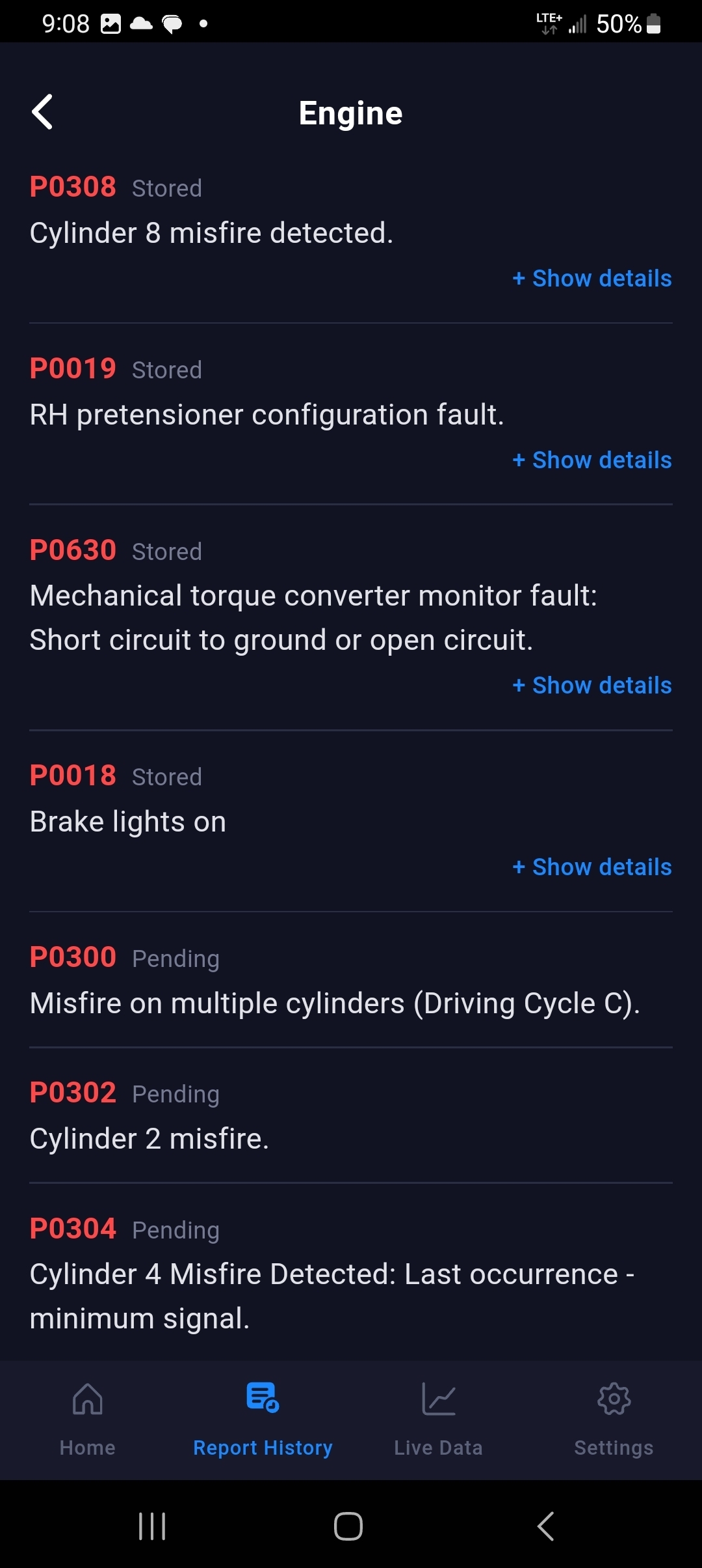

Thank you for the suggestion, Steve. So, I went and bought a simple code reader that allows me to erase codes when done with a report. After a few reads that gave a few different codes in addition to the same ones, i drove the vehicle to create a new drive cycle. On the first read the. Rover showed 4 instead of 8 cylinders misfiring. 302 to 308, all even number ones on drivers' side of engine. 304 and 306 read differently than 302 and 308 (attaching pic of report), i also Got a 0300 and 0316 code and poo18 p0019 and 06xx code too. The report mentions codes in order as stored, pending, permanent. It appears permanent are a few codes less than the other groups. I'm confused about it all. Two real time occurrences starting and driving. Engine turns over, but stalls when rpms lower to idle. Will stay cranked if the RPMs revved over 1,000. Shifting to drive from neutral with RPMs revved up at 2000 vehicle rpms drops almost to stall, does its shake, rumble and groaning then picks up movement and speed. Shifts maybe 3 or 4 times with speed topping at 50ish teetering back and forth on another shift depending on if I had a tail wind to push me past 55mph. On the first few shifts in momentum vehicle shifted slower if I pressed harder on gas pedal vs. more lightly. I went to get a loaner fuel pressure tester but counter guy said there's to fuel pumps. One behind head call a high-pressure pump that reader wouldn't work on saying he thought from vehicle current performance description I gave that would be a more probable target than fuel tank pump which pressure tester will Guage pressure on. I'm not sure what to do now. He kind of talked me out of my reason for going there but afterwards thought I should probably check it anyways because his opinion Doesn't make it fact on my vehicle because his Mini Cooper experienced that scenario. Even it's more probable than possible, I kind of feel like I should still check fuel pressure to rule in or out on tank pump that pressure tester tests.
What is your professional suggestion, Steve?
One more real time fact...I can Rev rpms up to about 3 to 4 k at idle in park keeping rpms constant at fixed pedal pressure, if that helps on repair suggestion probability for fuel pressure / ignition related symptoms.

Codes are basically Stored = Current codes it has. Pending = codes that have set one instance but have not turned on the light yet and Permanent = Codes that set and that will not clear until the issue is repaired.
The P0300 would fit due to the other misfire codes. It basically is redundant telling you that you have more than one cylinder misfiring.

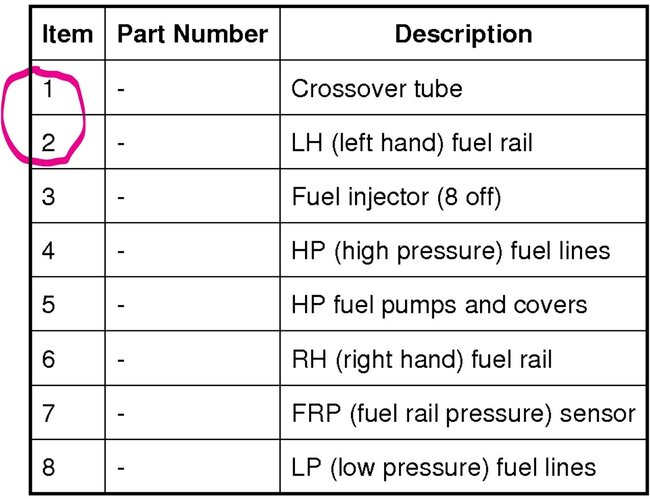

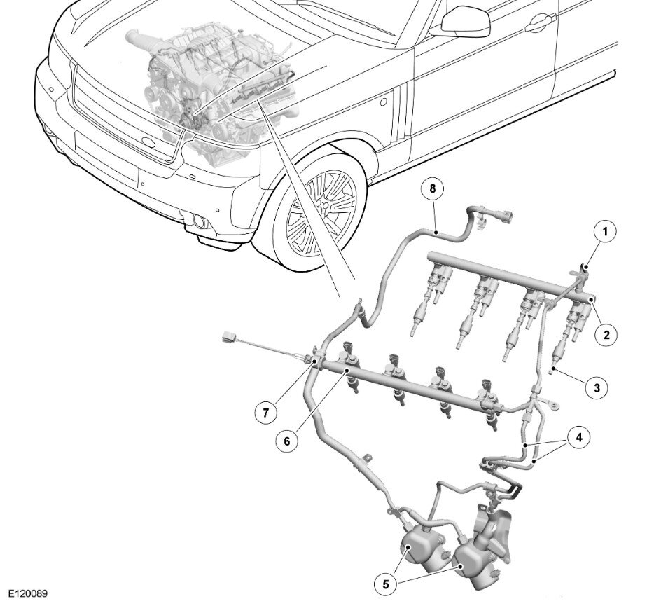

The P0019 is a seatbelt code, the P0018 means that the brake lights were on while you had the engine running P0630 is a transmission code. None of these will cause the misfires you have but the P0630 could be caused by the misfires. Now that you know it is only one side misfiring it does narrow it down some. It does have two high pressure pumps as well as the in tank. The only filter is on the in-tank pump. With the single bank misfire codes, it could be that sides high pressure pump. Plus, your reading of the code points to a known problem that has a TSB on it. LTB00409NAS4 issued 25 OCT 2013
You can read it here
https://static.nhtsa.gov/odi/tsbs/2013/MC-10214023-9999.pdf

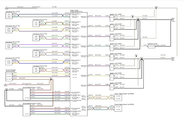

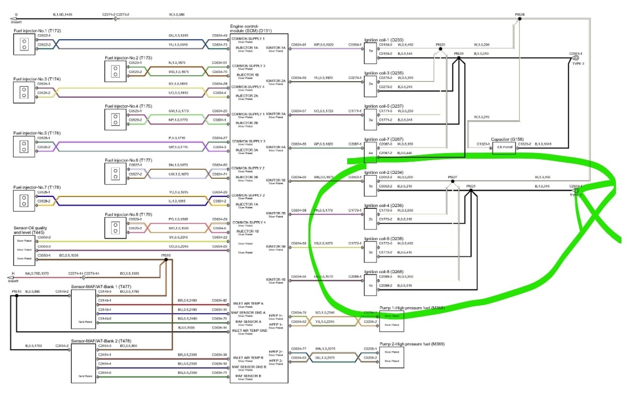

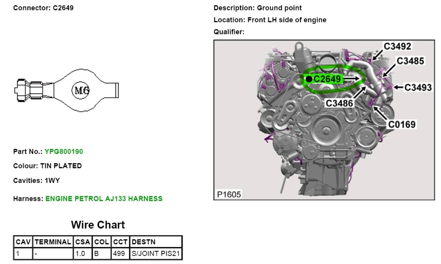

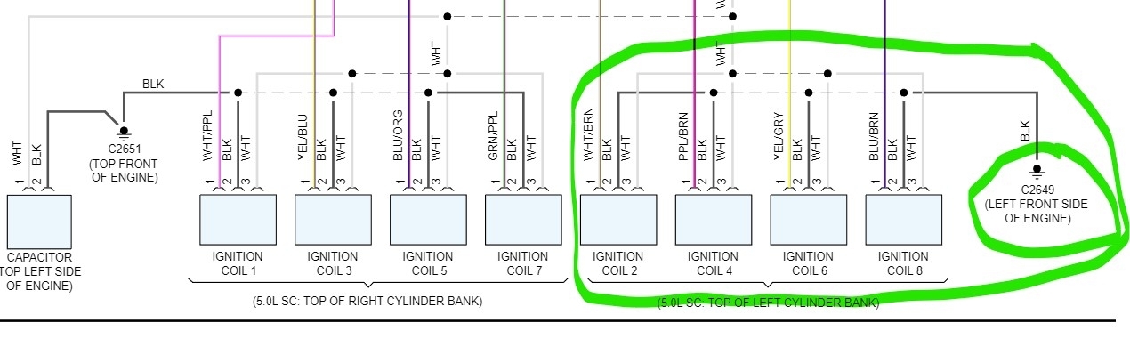

However, I'm thinking that it may not be the problem. Being a single bank misfire there are not many things that only apply to one bank of the engine. In this case the main single item is a ground point for all of the fuel injectors on that cylinder bank. A bad or missing ground would also show as misfires. Both sides share a power feed but not a ground. A simple way to test would be a cheap test light. Connect the light to battery positive and then pick the easiest injector connector to get to and unplug it, use the test light to touch the middle pin (black wire) in the connector. That is the ground pin. The light should light up strong. I suspect it may, but the ground still may be corroded. The ground would be at the left front of the engine, and it would have 4 wires all crimped into a single ring terminal. That style connection is very bad for corroding. I would look there first. Then if cleaning or replacing that ground point doesn't change anything, I would test the power side of the injectors as well, for that you connect the test light to battery ground and touch pin 3 (white wire). If it lights, then it should have power. If those are both good, then I would look at the TSB. Be warned that the parts are not low cost, and you will need a labor guide to do the repairs yourself as Rover tends to complicate many vehicles. For the guide you can get a DIY version of the service information from either Mitchell (eautorepair.net) or Alldata (alldata.com). They both offer monthly, yearly or multiyear plans for a single vehicle with Mitchell being FAR more affordable and they offer money back if you get in there and discover that the DIY side tosses around things like "Take the vehicle to a dealer" instead of listing a repair. I'm not sure if they do that but in some of the DIY "service" manuals out there it was a common thing to make it seem like the dealership had special powers.

I've went through the steps you suggested, with the exception of removing that ground on the front left of engine. It appeared I would have to remove some water hoses to get to it. I did put a wire brush to it the best I could, for sake of cleaning any corrosion/dirt was there. It did light up on ground test with the test light connected to battery positive before and after putting the wire brush there. The wire connectors going to coil packs all lit up on the ground test, however the power test to those did not light up when using the test light to test that, connecting to battery ground and touching the white wire connections. When you said test the ground and power to injectors were you referring to that connector that connects to coil packs? I did another read on obd2 tester and all 8 cylinders misfiring codes popped up again as well as p052c, p019, p018. P0300.

P0316, all 13 codes saying permanent with 2 showing pending on last read for p0630 and p0193. If I used the test light correctly as you mentioned, what does no light testing power to coil packs suggest? Or did I test wrong area when you said test power to injectors?
Jun 1, 2023 at 10:50 AM
STEVE W.
  • 15,348 POSTS
If you have the key on and don't have battery voltage on the white power feeds to the coils go check fuse 20.
