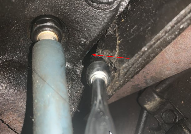

There is a hole around the oil dipstick tube in the engine, is the repairable?
Jun 8, 2020 at 8:41 AM
Normally not but anything is possible. However, I think it would be better if you got a picture of what the issue is and we can figure out a way to try and fix this. Clearly the thing we want to make sure is the repair will last so that you are not dealing with a leak or other issues moving forward.
Let me know if you can get a picture and post it and we can go from there. Thanks

I do have a picture.

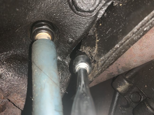

The second picture.

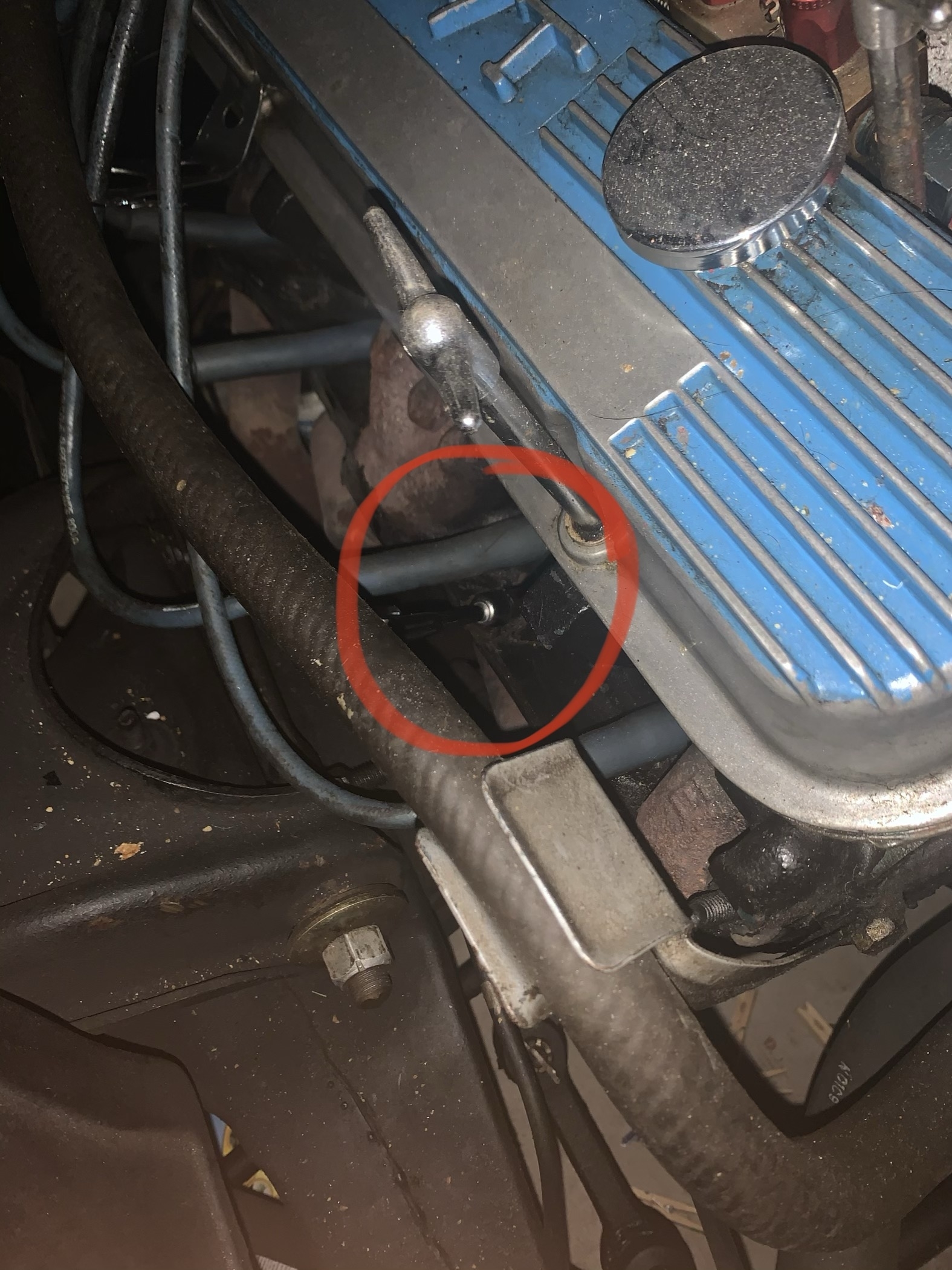

I am having a hard time seeing where the hole is. Take a look at the picture. Is it where I am pointing?
Is there oil coming out of the hole when the engine is running?

Yes, I can start the car and it’s fine but once the engine gets hot the oil spits out of the hole and all over the hot pipes causing it to smoke out the engine bay.
Jun 11, 2020 at 10:38 AM
Okay. If this is spitting oil then I would try and seal this with JB weld 2 part epoxy. Clearly once you do this, you will not be able to get the dipstick tube out but this is better then replacing the engine block. Clearly we don't want to force the JB weld down into the engine block too far but just enough to plug the hole.

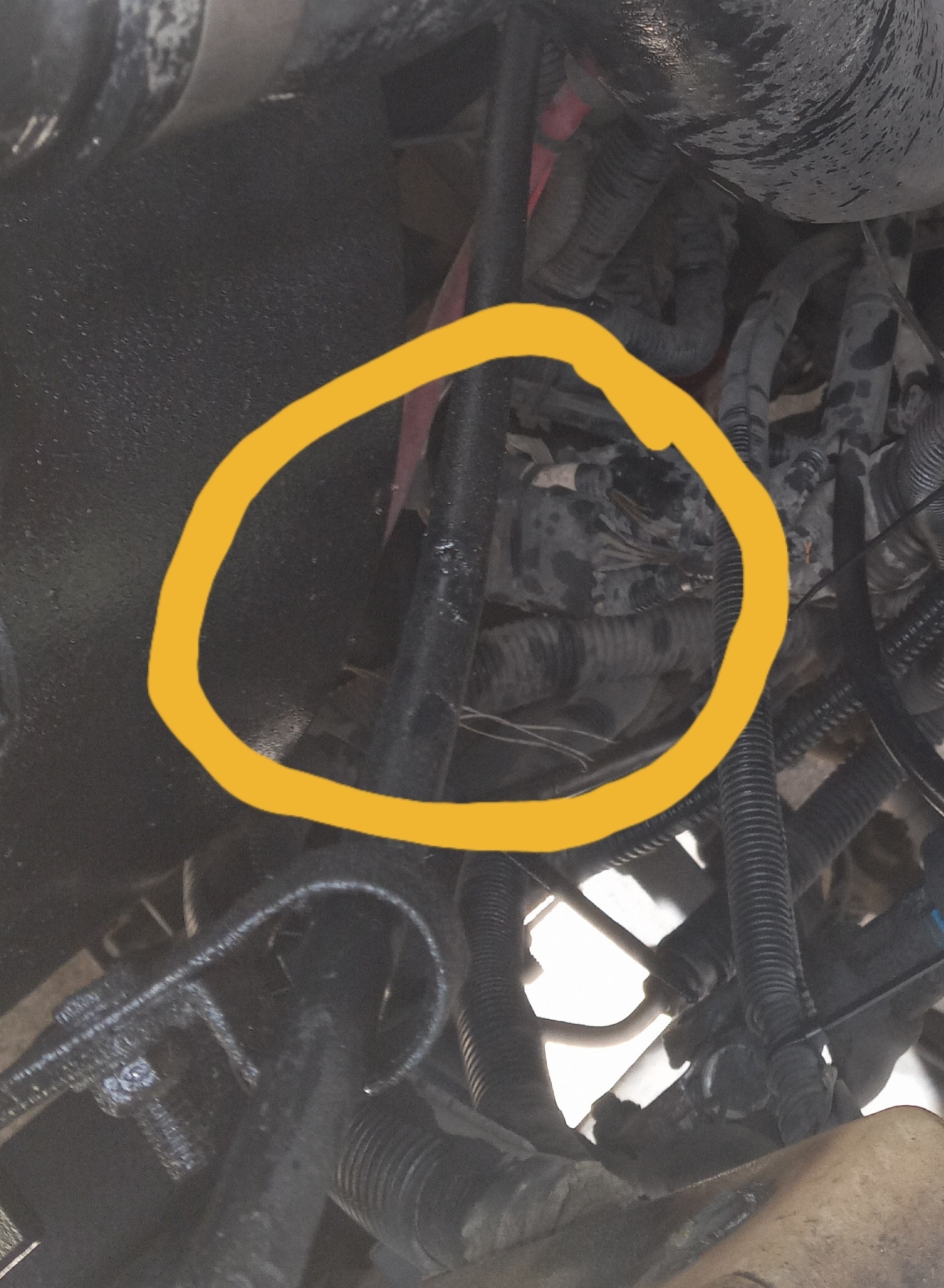

I am having a similar problem with eh hoke halfway up the tube and it is spraying as a result. This is with with diesel engine and the hole is in the dipstick tube which seems to be made of rubber or plastic would it be possible to patch with the jb weld fiber tape or any other suggestions? Said dipstick tube is on back order since last August so I don't think I will be able to obtain a new one.

Hello sorry, I didn't realize this was a car specific thread. actually, it's a 2004 Freightliner MT35. the hose is a hard rubber/ soft plastic material.
