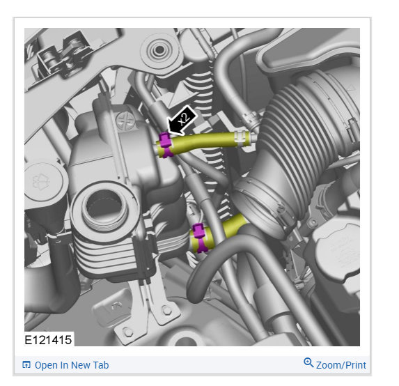

This vehicle has an expansion tank. Due to having the wrong coolant I suspect there is some build up in the system. Have you removed both lines from the tank and checked to make sure they are not clogged?
Is the coolant bubbling and then pushing out of the bottle?
I suspect that the coolant cannot expand to the bottle and it causes it to "back up" in the system and it pushes back up the supply line or return line.
I would pull them off and make sure the bottle can flow and the lines shown in the picture.
Let me know and we can go from there. Thanks

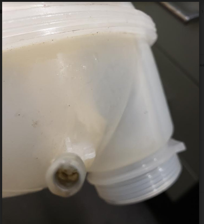

If the cap is off, it doesn't bubble but it just rises up and out of the tank. Of course we can only fill the bottle so it's basically just the coolant we added moving up, then after cutting off the vehicle when it runs hot and sits will it go down and can add more.
Feb 24, 2020 at 1:15 AM
Okay. I just had a Jeep doing this exact same thing and the recovery bottle had a plugged return line. We couldn't see it with the line on it but the entire cooling system had been replaced due to contamination, except the bottle. We just assumed it was fine because it was just a bottle.
I would pull the lines and make sure you have no obstructions. If it is not here, I am sure you have an obstruction, we just need to find it.
