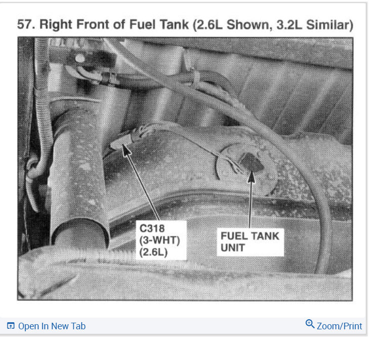

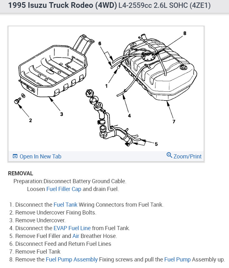

I have a problem with my 2kd engine,started when I was drive with loss of power my revs were so poor then after a check up I found that when I crank the car I'm not getting diesel from the rail to injectors thus I do get diesel from pump to rail please help
Oct 9, 2018 at 1:23 AM
  • 54,837 POSTS
No diesel to the rail means the primary pump in the tank is not working. Most of the time its the pump or relay that is causing the problem here is a guide to help you see what you are in for when changing the pump out and diagrams below to show you on your car.
https://www.2carpros.com/articles/how-to-replace-an-electric-fuel-pump
Oct 9, 2018 at 11:15 AM
ITUMELENGTUMZA50
  • 9 POSTS
Thanks Mr Ken, I checked the car again and now the diesel pressure is correct, but I found out that there is no signal to pump and injectors. Could this mean my computer box is damaged?
