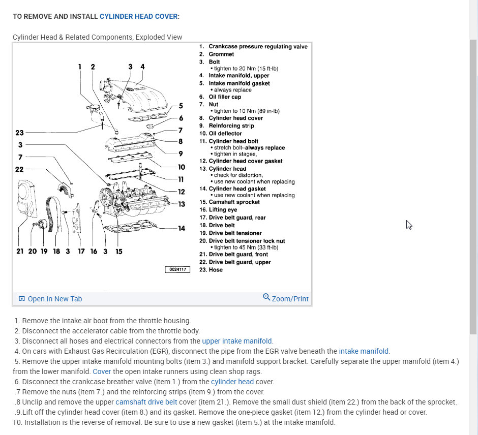

More than likely you have an issue with the spark plugs or coils. Have you removed the cover and inspected the coils? I suspect you have an oil leak causing a misfire. It may idle fine but once you introduce the load it stalls.
Let's start with pulling all the plugs and coils and look for oil.

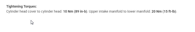

Here is the process for the valve cover gasket as I suspect this is the ultimate issue.
Let me know what you find and we will see if we have proof to what I am thinking. Thanks
