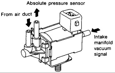

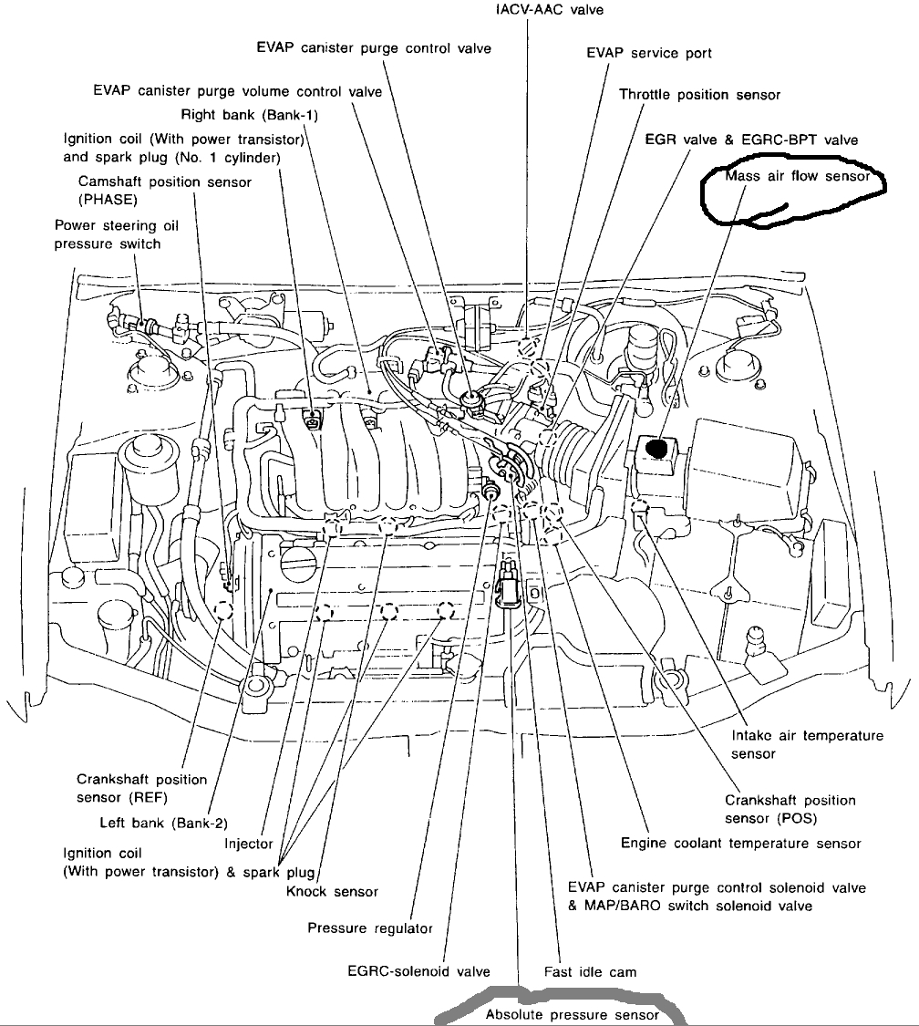

Is the part in the first picture what you unplugged, it is at the bottom of the other picture or was it the unit out in the intake tract? Just realized we may not be talking the same part.
May 6, 2018 at 6:52 AM
MRMEXICO66
Yes, it was the mass airflow sensor I unplugged. I also noticed when I was pulling codes by turning the dial on the ECU there were no lights lit up on the side of it. What does that mean if anything?
Jun 16, 2018 at 4:35 PM
STEVE W.
  • 15,352 POSTS
Okay, that is a bit different. The MAF on Nissan vehicles does not like to be plugged in with the power on. The MAP that you referenced earlier would be okay, but the MAF is a different animal. With that it is possible that it damaged the ECU.
