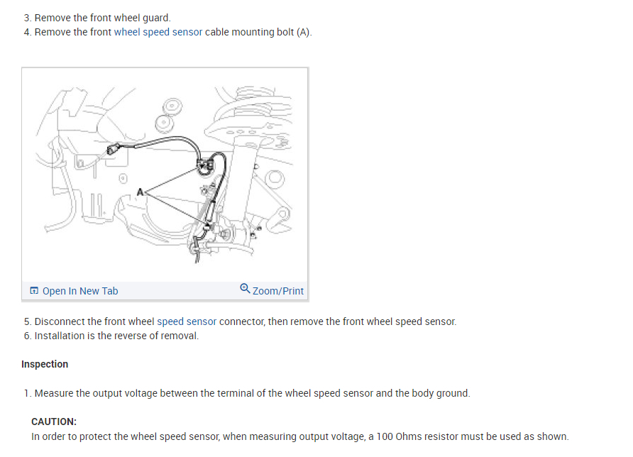

i have problem with the car listed above (Korea). when i put my foot on the brake i hear noise and feel regular vibration still until 5 second and disappear , and this is continuously happening .
One time when i am driving there was an error message "check brake " , and when i restart the car , the message went away.
can you help me to resolve this problem please ?
Jul 4, 2021 at 4:49 PM
Good morning,

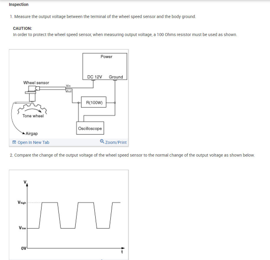

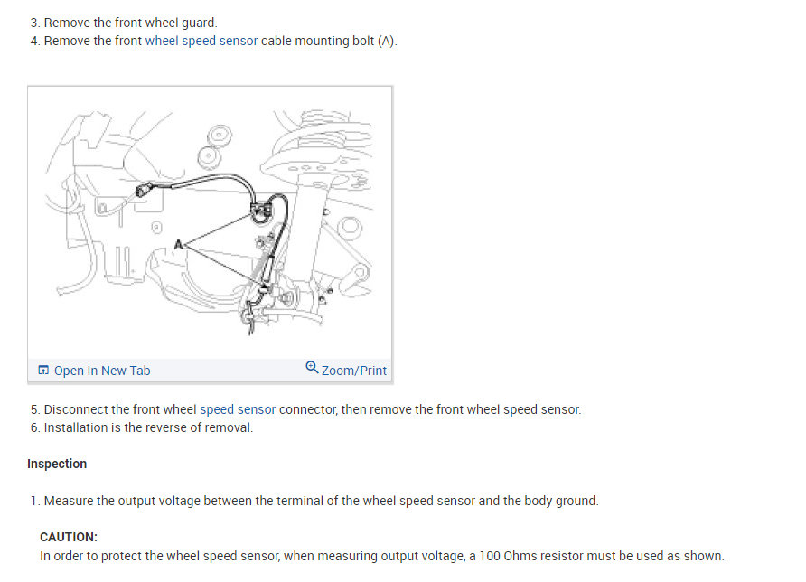

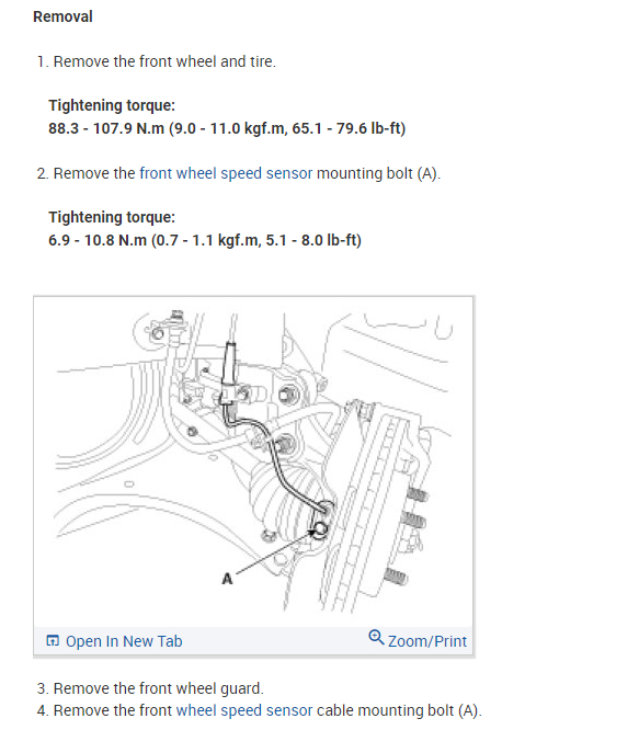

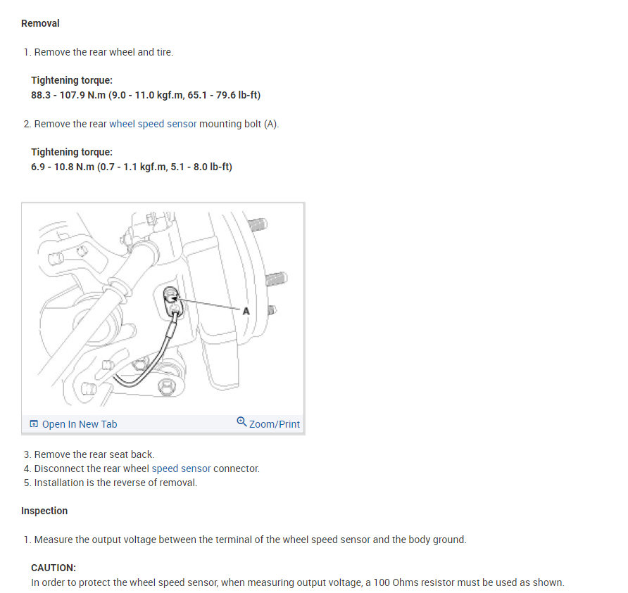

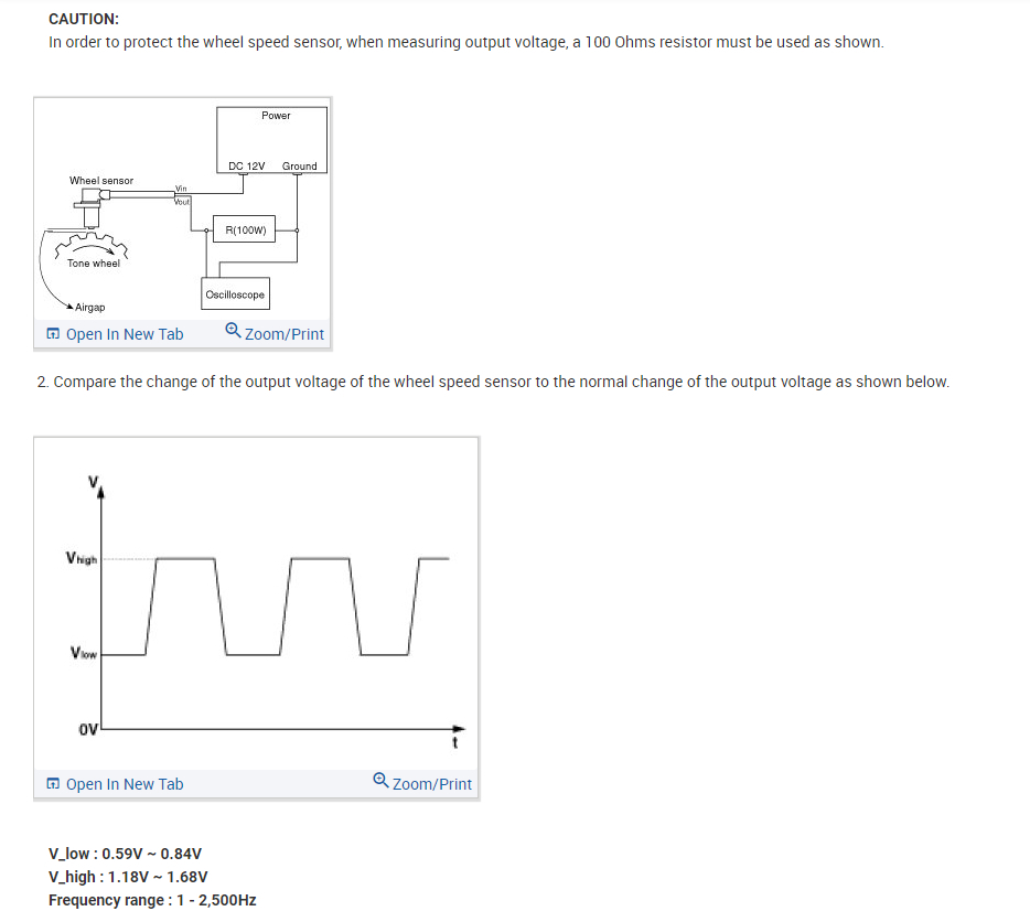

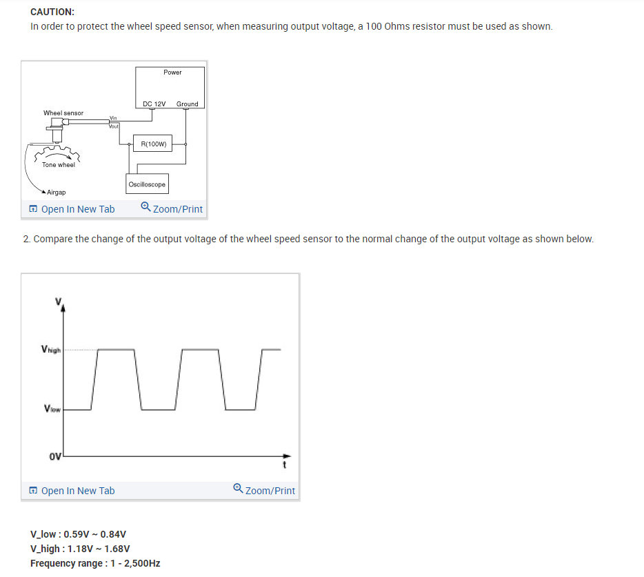

This sounds like one of the ABS sensors is causing this issue. The mountings get dirty with road dirt and cause signal issues.
I would clean all the mounts with a wire brush and then reinstall and tighten the sensors. Then road tests it and sees if it still happens.
https://www.2carpros.com/articles/abs-wheel-speed-sensor-test
https://www.2carpros.com/articles/how-to-replace-an-abs-wheel-speed-sensor
If it does, then you will need a scan tool that can monitor wheel speed to see what sensor is causing the issue.
I attached the procedures for removing the sensors for cleaning.
