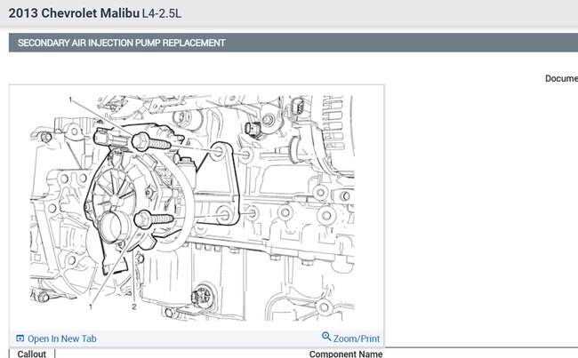

What parts do I need to delete the air injection system off this car?

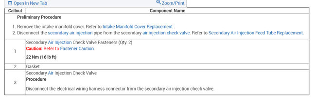

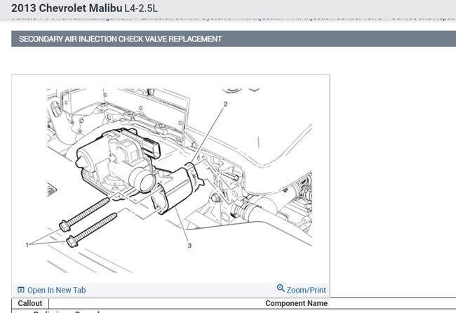

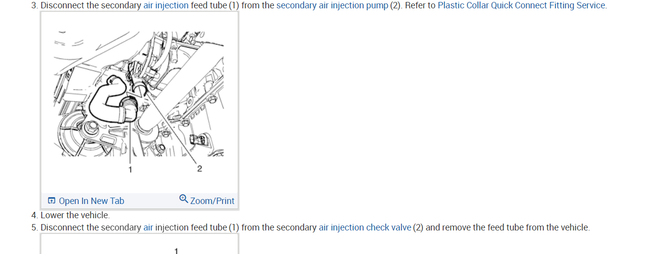

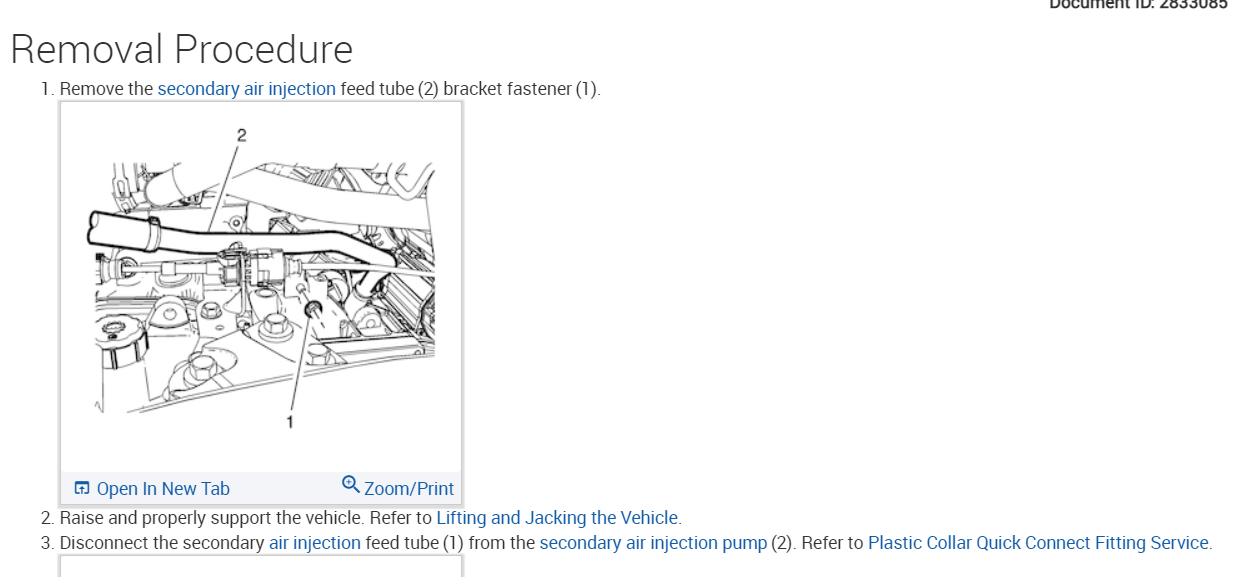

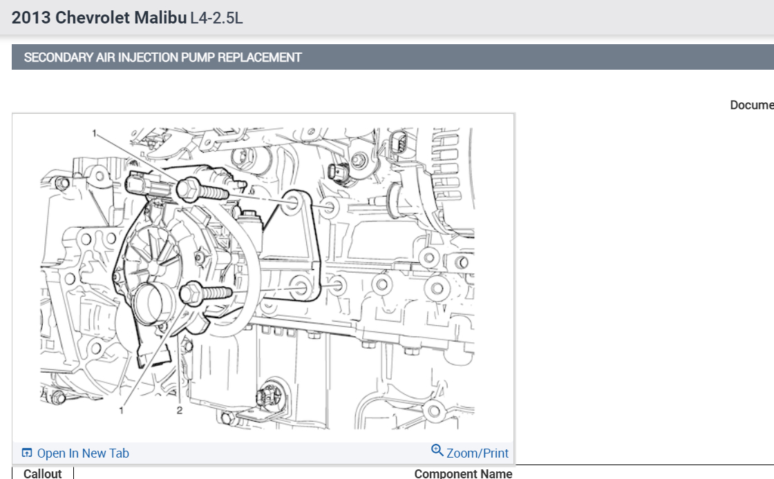

Also here are the components so you can see how the system works and if you tell me which code you have, I can help you fix it.

P0411 A secondary air injection system insufficient airflow fault condition has been detected.
So, this can be because the air passages or clogged or the pump motor has worn out. You might be able to remove the pump motor and disassemble it to find a stuck check valve or diaphragm.

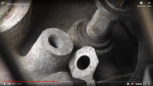

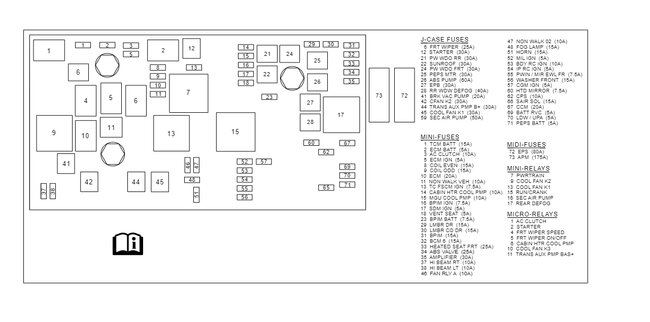

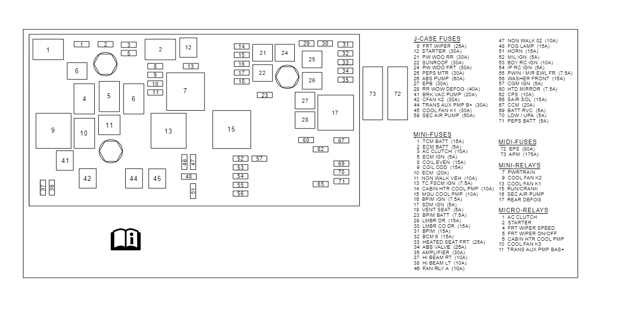

I did find a video that shows the system having a bad ground which is on the transmission here is the location so you can check it out. The ground I found has on the cylinder head, also there is a fuse and 2 control relays we should check or swap out in the under-hood fuse panel. First fuse (sec air pump fuse) and then the (cabin heater cool pump) fuse here is a guide to help test them for power.
