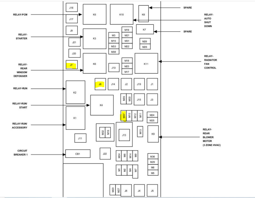

Hello. I have a few issues with my vehicle listed above. I need to replace my ABS Control Module... my speedometer isn't working, and I have a constant TPMS light that stays on even when the tires are properly inflated. My error codes are U1110 and U1120. I have a constant ABS and brake lights on the dashboard.
Within the last week I started noticing acceleration and shifting issues. The vehicle seems to delay getting out of 1st gear. I'll be stuck at 40mph for a while on the expressway before it changes gears and the speed finally increases. Twice it has shut off, once while making a right turn and the other time while fully stopped at a light. The vehicle was able to re-start immediately.
The additional error code is PO507. Is that related to the electric throttle control actuator?
Would the TCM have anything to do with it? Where should I start? Any info would be greatly appreciated. Thank you!

The U codes indicated are both related to wheel distance and speed. That is why the transmission is having trouble shifting. Also, one of the most common causes for these codes is a loss of power to the ABS module, which could explain why the light is on. The P0507 indicated a high idle which is likely caused by an engine vacuum leak. On these vehicles, it isn't uncommon for the PCV to fail. Here is a link to help locate a leak.

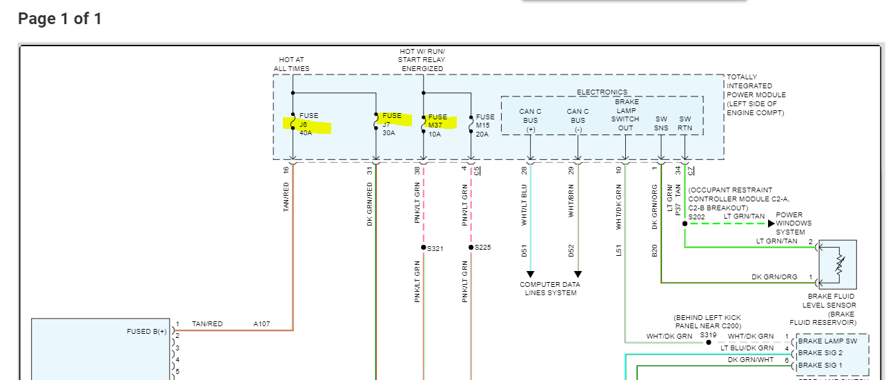

So, the easiest thing is to check if the ABS module is getting power. If you look below, I attached a pic and highlighted three fuses. These are power supplies to the ABS module. I need you to check the fuses and confirm there is power to and from them. (Pic 2 shows the fuse locations in the under-hood power distribution box)
Let me know what you find.

Hello guys! So, I replaced the ABS Control Module. That cleared up the speed and wheel sensor issues. Also, my catalytic converter was completely clogged which was causing the vehicle to lag up to 40 MPH. Replaced the converter which immediately cleared that issue. Vehicle seems to be running good now.
