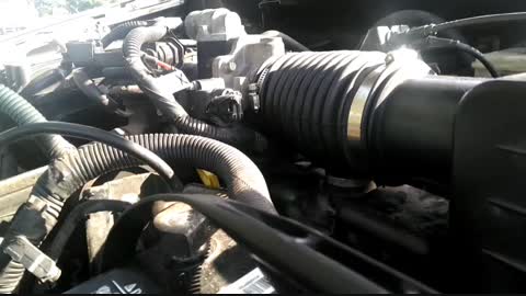

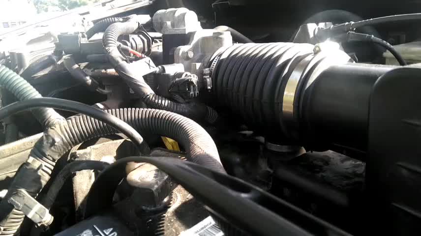

Here's a video with 2 separate starts I did this morning.

At first, it sounded like something was loose and rattling. But I certainly heard it.
Here is what I need. I need you to video it with the recorder under the vehicle, then in front of the engine so I can tell if it is a possible timing chain, and from the top.
Let me know if you can do that.
Jun 14, 2022 at 8:38 PM

So, this was taken rather hastily as I'm not trying to run the motor too long. The banging is coming from the driver's side now, but I swear it's moved from the passenger side. It almost sounded like a pulley, but the timing chain does make a good suspect. However, the last clip in total darkness is from the driver's seat with the door open facing down and it sounds like broken glass. This could simply be the hose clamps loosening but it sounds a lot more destructive than a metallic rattle. I have three days to get this van out of this parking lot and if I have to tow it then I'm going to be buying a different van I found earlier. I don't want to give up just yet though. Should I retrace everything I did to the engine, like removing intake manifold and rechecking spark plugs? It sounds great at idle, that's why it's almost like the knocking is a separate behavior. Kinda like when you put sneakers in the dryer and they randomly make noise, at least that's what I heard.
EDIT I do have a stethoscope now as well so if you tell me specifically what to test, I can try to put the earpiece up to the mic. I also have a decent omnidirectional mic I could use on my laptop, but it would be audio only if that would help. Maybe from underneath the motor it would give a new perspective.

I'm glad you recorded restarting it. It sounds like the timing is too advanced. If you notice when cranking, it turns, sounds like it is going to stop, and then continues turning. Has it always done that? Do me a favor. Make sure the starter is tight. I know you did a lot of work on it, so I'm not sure if you removed it for anything.
The next thought was the timing chain. However, the timing chains are at the front of the engine which is the passenger side. Listening to the video, it does sound louder on the driver's side which is where the transmission is located. That's why I am questioning if it is something like the starter, a flex plate bolt that is loose or cracked, or something between the engine and transmission.
If the RPMs increase, does the noise do the same? I'm wondering if it is something with the flywheel, torque converter, starter... Again, the good news (at least from my point of view) is the sound doesn't appear to be something internal within the engine. It actually sounds like it runs well other than the noise.
I sent this video to another tech to get his opinion. To me, it seems to be something around the flex plate. It could be cracked, the starter drive gear may not be fully retracted and hitting off the flex plate, a loose flex plate bolt, or something between the engine/trans.
If you can, try to place the recorder right down next to the bell housing on the transmission to see if it is louder.
Let me know. Also, and don't laugh, take a rubber mallet and tap on the exhaust to make sure it isn't a catalytic converter that has come loose internally. I don't think it is, but they can make a lot of noise.
