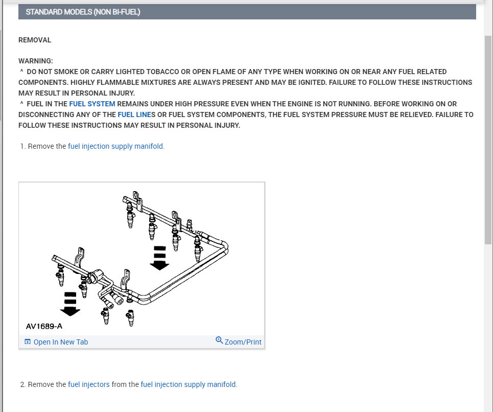

No fire on 2 cylinders. Unplug coil and it doesn't change how it runs. Swapped out coil's same thing. Replaced pug wire same thing not working.

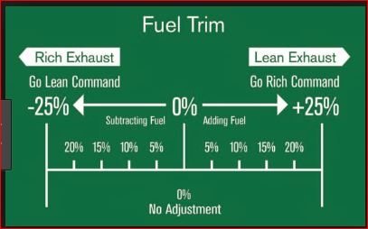

The next thing we should do is monitor the o2 sensor data if you have a scan tool that can do that. If not, it is not a big deal, we will just need to do a little more swapping of parts.

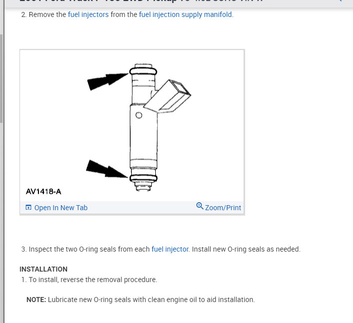

I would suggest next to swap the injector from this cylinder to another one and see if the misfire moves to that cylinder. If it does then you know the injector was the issue.
If the injector is not the issue, then we need to test the compression and make sure it is not a weak cylinder. Here is a guide for doing this:
Please run through this and see the info attached below and let me know what you find with this. Thanks
