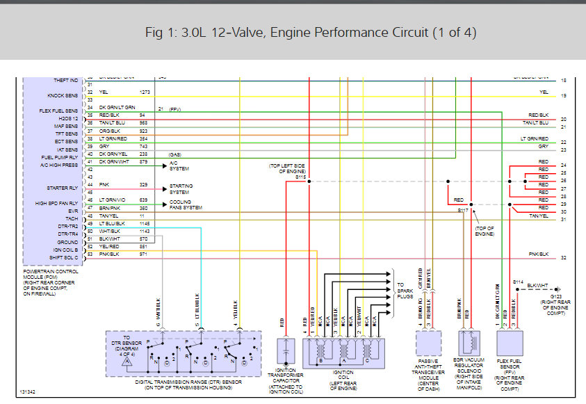

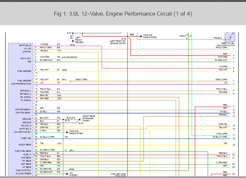

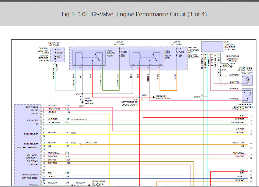

The issue on that is that I'm having trouble figuring out how to disable the fuel system. I can't seem to find the fuse for the fuel pump. I've looked online and my car has no fuse in the slot where it's supposed to be.
Apr 1, 2019 at 8:04 AM
SCGRANTURISMO
  • CAR REPAIR CONTRIBUTOR
  • 4,897 POSTS
Hello again,
There are a couple of ways to disable the fuel system. You could unplug all the connectors from the fuel injectors, you could unplug the connector from the inertia Fuel Cutoff Switch located behind the right rear tire in the trunk fender well, or you could take out the fuel pump relay located in the battery junction box behind the radiator. Any one will do the trick. I have included some informational material in the diagrams down below. Get back to us if you need more help or have additional questions please. That's what we are here for.
