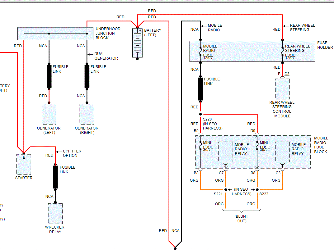

Hey Joe , i took the battery to oreiilys to be tested and charged and they said the battery was shot so i got a new one today but now i dont know if it was the parking lights. I hooked up the battery and it started sparking at the connections a lil bit but majorly sparking from the wire or cable coming out of the bottom of the fuse and relay box under the hood . It will run long as its not arking but will die completely in the road when it arks and wont restart without wiggling that wire.

Hi:
What wire are you referring to? If you are getting arcing from the fuse box, that is a problem that could lead to a fire or other issues. Can you take a pic of the wire you are referring to and upload it for me to see?
I attached a portion of the wiring schematic. Do you see which wire it could be?
