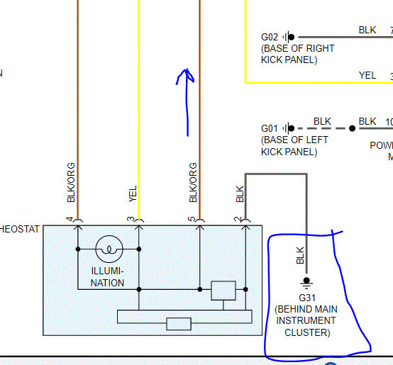

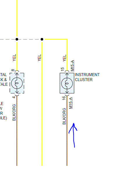

Dash lights come on sometimes and sometimes do not when car is started up. Sometimes flipping the switch on and off numerous times it will come on.

The only lights that are affected are the lights that handle the speedometer and RPM's. All the others work fine. I turn the handle on the left hand switch to turn the lights on and off for those lights. Nothing with the head lamp or any other lights.

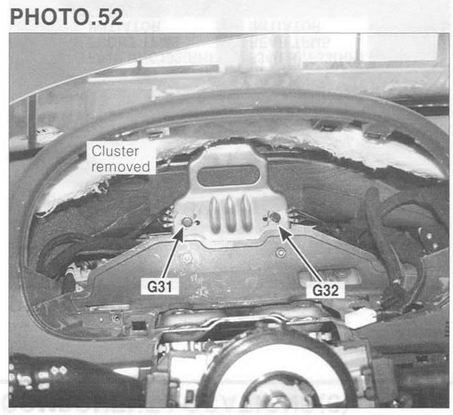

Since they work at times, then we know it isn't a fuse related issue. So, either we have a weak connection at the instrument cluster or a weak ground.
If you look at the attached pics, they show power (via a black/orange wire) to the instrument cluster. Also, it shows the rheostat ground for the lighting. What you need to do is first check to make sure the power supply to the instrument panel lighting is tight, not damaged, and in good condition. If it is, then we need to confirm a good ground under the dash.
Here is a link that you may find helpful when doing this:
If you look at pic 3, it shows the physical ground location with the cluster removed. (G31)
