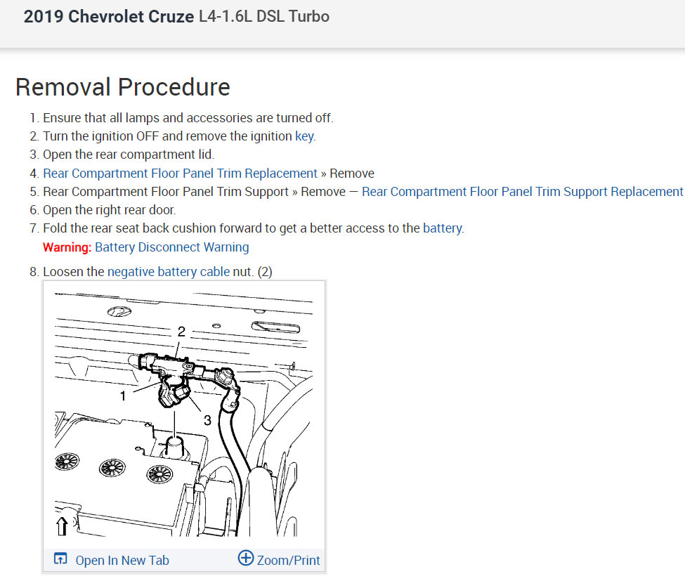

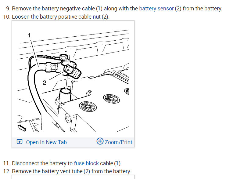

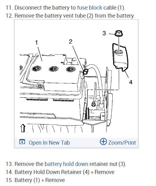

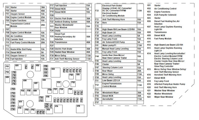

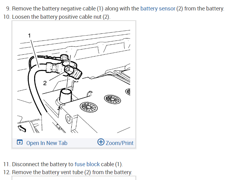

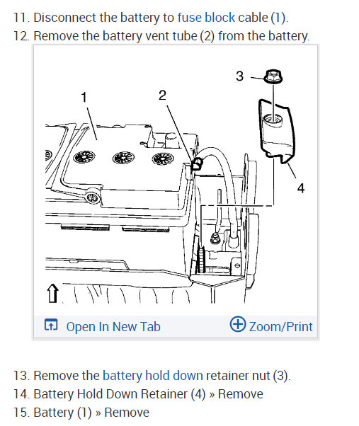

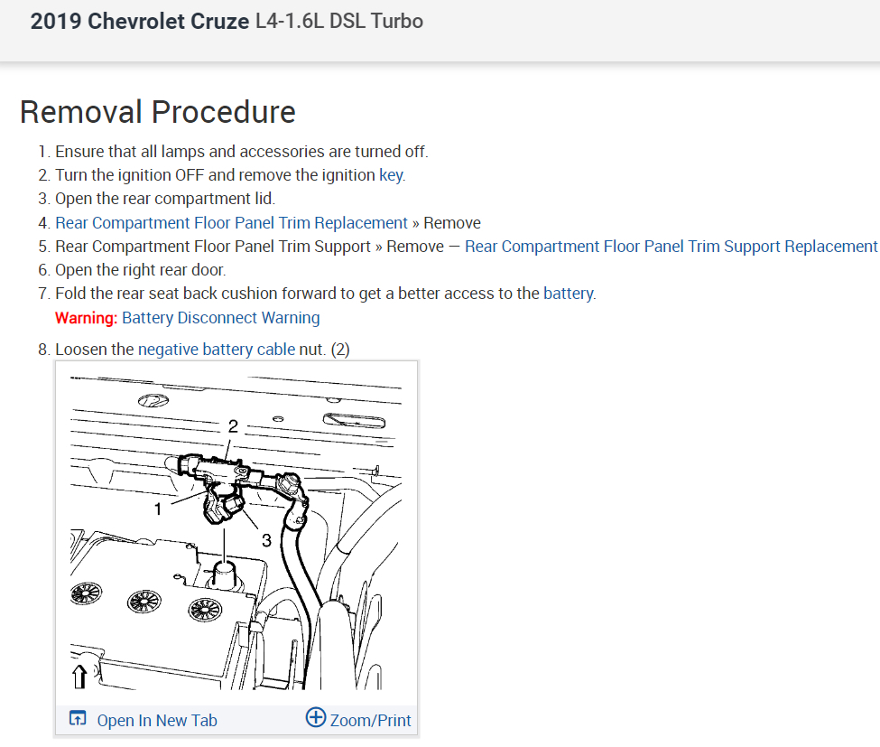

Yes, if the battery is dead, you will have this problem, if the battery is original then it is over 5 years old and needs replacement. I would remove the battery and have it tested at the auto parts store. Here is a guide to help walk you through and instructions in the images below for your car:
https://www.2carpros.com/articles/how-to-replace-a-car-battery
Check out the images (below). Please upload pictures or videos in your response of any problems so we can see what to help you with.

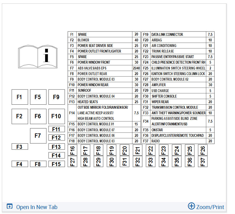

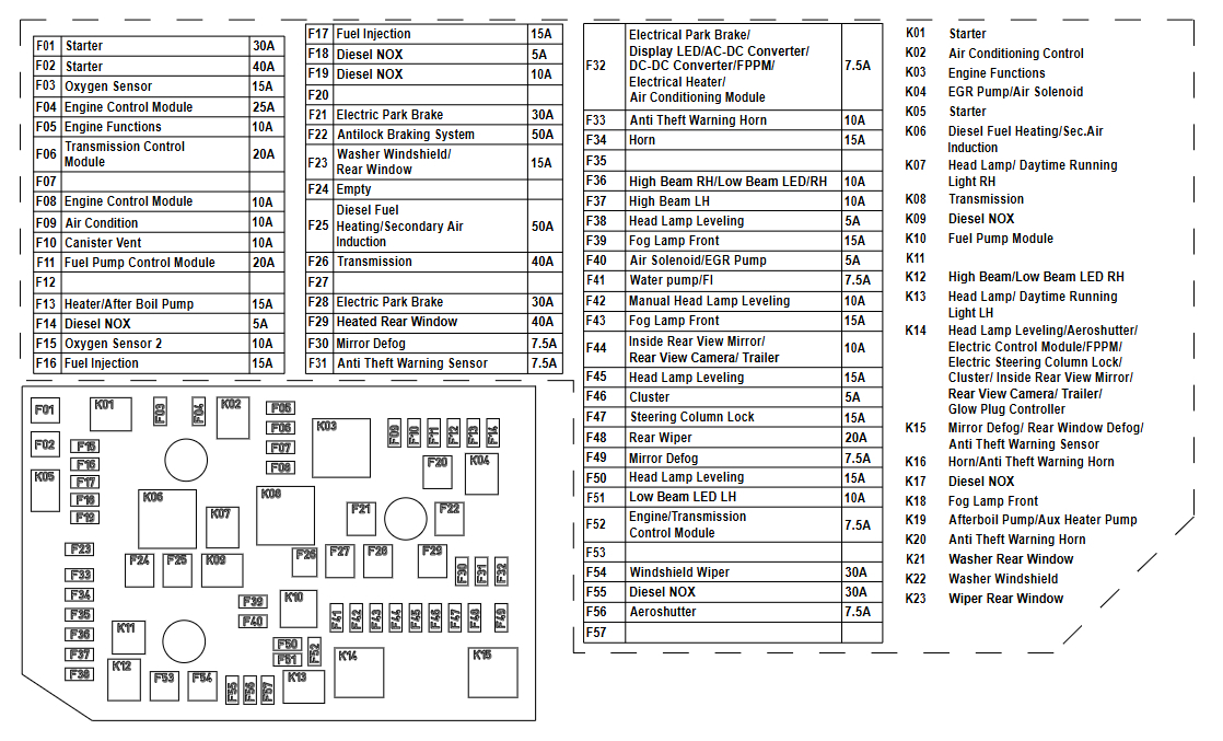

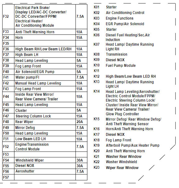

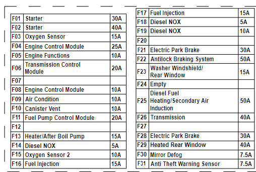

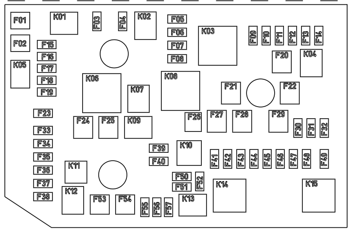

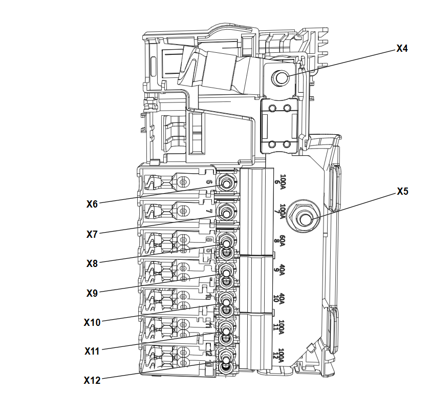

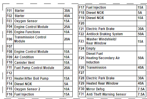

Was this car in a flood or in an accident? I would check all fuses, this guide can help, and I have included the fuse locations in the images below.

I replaced the battery current sensor and the battery and now my car won't start, dash still no illumination. no GPS, no radio, no AC, and no heat. water intrusion from third brake light. There was water in my spare tire reservoir. I drained and wiped it dry and when I replaced the battery, I cleaned the corrosion off the battery tray and then installed a new battery and replaced battery current sensor. still no luck.

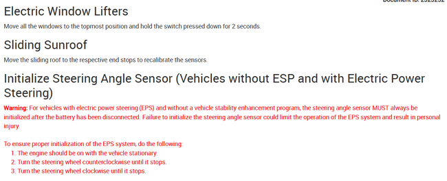

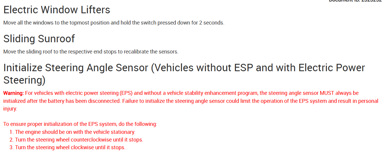

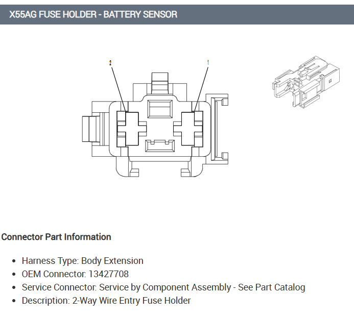

If you replaced the battery currant sensor you need to program the volatile memory. This is how in the images below

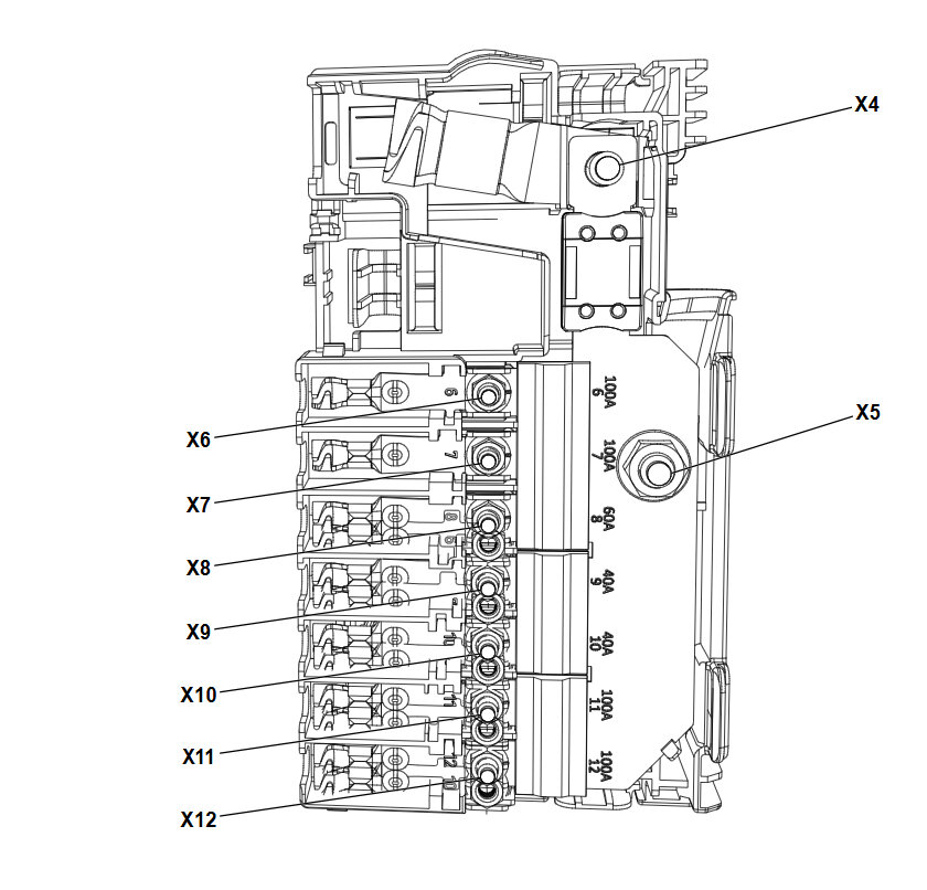

Also, I would turn the ignition system on and then start checking fuses, also check the battery ground, you have lost a major part of the electrical system.
Check out the images (below). Let us know how it goes.

Yep, I would try that first, but is still seems like there are some power issues we are not seeing, did you check the fuse panels for power when the systems are on? Did you got over the instructions in the post above?

I would not bring the car to the scrap yard. The problem can be something simple. I would use the test light to see what does not have power in the fuse panel.
